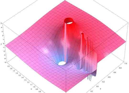

that allows us to produce this picture of the imaginary part of $I(s)$ for $\Re(s)>0$ :
imaginary part
We observe a jump of amplitude $\pi$ (near the line $x=\Re(s)=0$ at the right around the line $y=\Im(s)=0$) coming from $\frac {\ln(s)}2$.

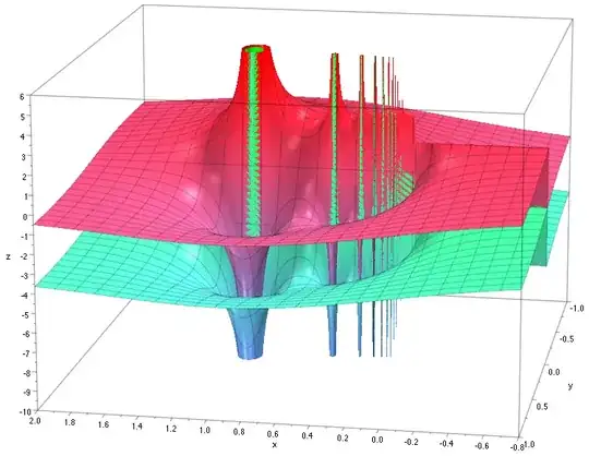

Let's observe that our expansion is analytic everywhere except at the simple poles $s=\frac 1n$ and the branch point $s=0$ allowing us to show the pictures of the imaginary and real part of the (possible) Riemann surface of the analytic extension of $I(s)$ on the whole plane (imagine an infinity of sheets superposed around the branch point $0$ generated by the $\frac {\ln(s)}2$ term) :
imaginary compl
real compl

  • +1. For your effort! Which software did you use for plotting? It looks really nice! –  May 24 '12 at 00:04
  • @Marvis: Thanks!! It's MuPAD (in Matlab now) and it generates even animations. – Raymond Manzoni May 24 '12 at 00:07
  • @RaymondManzoni Nice. I was not aware of MuPAD. Thanks! –  May 24 '12 at 00:40
