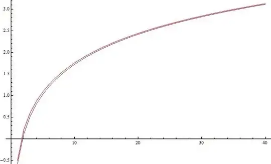

Plotting the left hand side (red) and the right hand side (blue):
right hand side left hand side
we see that they are close to each other. Mathematica program for the plot:

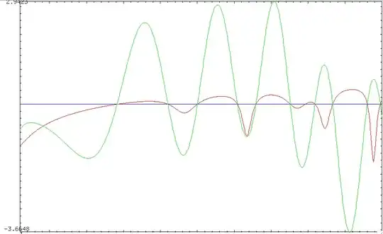

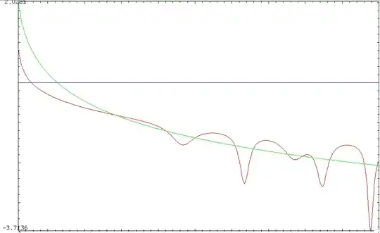

Let's illustrate this by showing the left (irregular) $\,\Re\frac{\zeta''(\rho)} {\zeta'(\rho)}$ part and right (regular) $-2\theta(t)$ part of $(8)$ for $1<t<50$ :
left and right part of 8
If we subtract these two curves we will obtain a new curve taking the value $0$ only when the formula $(8)$ applies. The second curve is the real Riemann Z-function (i.e. $\zeta$ 'without the phase') taking the value $0$ only at the imaginary parts of the zeros :
zeros of zeta
In the $(1,50)$ range considered $(8)$ has only one additional solution for $t$ a little smaller than $40$.
