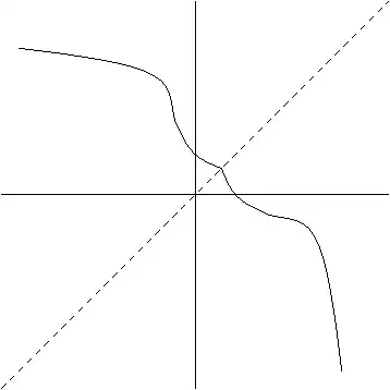

And David Quinn and Maciek raise a good point--which is that any function which is symmetric about the line $y = x$ is an inverse of itself. Just because you may not be able to "write down", algebraically, such a function doesn't mean one doesn't exist. Here's an example graph from a function which is its own inverse:
And you can create all sorts of different looking such functions by just drawing some curve (it must pass the horizontal line test) and reflecting it by the line $y = x$ (which is how I generated the above example).
