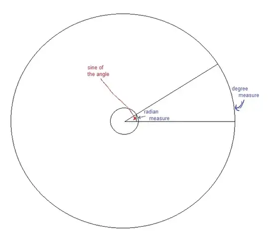

    I believe it has to do with the fact that an arc-length is given by $\theta r$ only if $\theta$ is measured in radians. There isn't anything special about this because we know (without radians) that the circumference of a circle is given by $2\pi r$. So if we define radians such that "$360^\circ$" is $2\pi$ then we get for the value of arc-lengths: $A_\theta = 2\pi r * \frac{\theta}{2\pi} = \theta r$ vs. degrees: $A_\theta = 2\pi r * \frac{\theta}{360^\circ} = \theta r * \frac{2\pi}{360^\circ}$. – Jared Jun 25 '15 at 23:48

    Degrees and radians are not "arbitrary units of measure" because angles are unitless. As pseudo-units, "rad" is the value 1 (unitless) and "deg"/degree-sign is the value $\frac{\pi}{180}$. – R.. GitHub STOP HELPING ICE Jun 26 '15 at 03:02

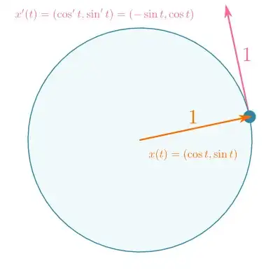

For convenience, let's measure time in seconds and distance in meters, so the unit circle has a radius of one meter.
Look at a point moving around the unit circle along the path $x(t) = (\cos t, \sin t)$. The usual trig functions are scaled so that the point will make a full circle every $2\pi$ seconds, which means it's moving at a speed of $1$ meter per second. In other words, the point's velocity $x'(t)$ is a unit vector.
Position and velocity for the usual trig functions.
Knowing this, it's not hard to figure out that $x'(t)$ is just $x(t)$ rotated a quarter turn counterclockwise. Now we have two ways of figuring out $x'(t)$: by taking the derivatives of the components of $x(t)$, and by rotating $x(t)$ a quarter turn counterclockwise. The fact that those two descriptions give you the same vector $x'(t)$ is precisely the fact that $$(\cos' t, \sin' t) = (-\sin t, \cos t).$$

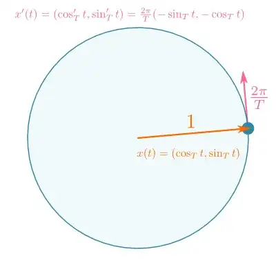

Now, what if we rescaled our trig functions so that the point made a full circle every $T$ seconds instead of every $2\pi$ seconds? Let's call the rescaled trig functions $\cos_T$ and $\sin_T$. When $T = 360$, we get the trig functions for angles measured in degrees.
Since the point is making a full circle every $T$ seconds, it's moving at a speed of $\tfrac{2\pi}{T}$ meters per second.
Position and velocity for time-rescaled trig functions.
You can calculate the derivatives of the rescaled trig functions using the same reasoning as before, and you get $$(\cos_T' t, \sin_T' t) = \tfrac{2\pi}{T}(-\sin_T t, \cos_T t).$$ So this is why setting $T = 2\pi$ gives derivatives with no extra factors: it's the scaling that makes $x(t) = (\cos_T t, \sin_T t)$ a unit-speed path.
