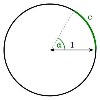

Look at the following picture. It is a circle of radius $r=1$ and there is an angle $\alpha$ that cuts out an arc $c$ from the circumference of the circle.
$\quad\quad\quad\quad\quad\quad\quad\quad\quad\quad\quad\quad\quad$
How long is this arc? Well, this is where radians are immensely beneficial. If you express the angle in radians, then the length of the arc is exactly $\alpha$. If $\alpha=0.123$, then the arcs length is $0.123$ too. Easy.
You know that the full angle in radians is $2\pi$. If you choose $\alpha=2\pi$ in the above image, you would describe an arc $c$ that is actually just the full circle. And you immediately see, that its circumference (here also the length of the arc) is $2\pi$ too. This is exactly what the formula for the circumference $U(r)=2\pi r$ would give you anyway.
Of course this is also useful for circles of radii other than $1$. If your circle has a radius $r$ and you look at an arc cut out by an angle $\alpha$ in radians, then the length of the arc is $\alpha r$. It just scales linearly.
