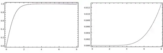

Here for instance are plots comparing $\tanh\,z$ and the convergent
$$R(z)=\cfrac{z}{1+\cfrac{z^2}{3+\cfrac{z^2}{5+\cfrac{z^2}{7+\cfrac{z^2}{9+\cfrac{z^2}{11}}}}}}$$
comparison of hyperbolic tangent and CF convergent
The left plot shows that the rational approximant and the actual function are almost visually indistinguishable, while the right plot depicts the function $\tanh\,z-R(z)$.

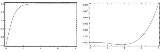

Here are comparison plots for $\tanh\,z$ and $\mathcal{T}_3(z)$:
comparison plots of tanh(z) and Pade-derived approximant
The left plot shows $\tanh\,z$ and $\mathcal{T}_3(z)$ together, while the right plot depicts the relative error function $1-\dfrac{\mathcal{T}_3(z)}{\tanh\,z}$. Note that the error is slightly smaller here than in the previous answer. One might still be able to improve on this approximant with a rational function with simple enough coefficients, but this is a start.

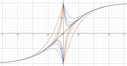

$$\tanh(x)=\operatorname{sgn}(x)\left(1-\frac2{e^{2|x|}+1}\right)$$
By geometric expansion we can rewrite this as
$$\tanh(x)=\operatorname{sgn}(x)\left(1-2e^{-2|x|}+2e^{-4|x|}-2e^{-6|x|}+\dots\right)$$
This expansion converges rapidly with an error of order $e^{-2N|x|}$ for $N$ terms, which is small when $x$ is large. It avoids any division here, and all of the exponentials reduce to one since $e^{-2n|x|}=(e^{-2|x|})^n$.
Below we show a plot of the approximations going up to the $\pm2e^{-2n|x|}$ term up to $n=8$:
All that's left to do is to approximate it near the origin, which can easily be done via Taylor approximations.
If this is still unsatisfying, an alternative approximation may be desired for $x$ between say 0.5 and 1.
