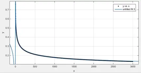

For discrete values Matlab offers a nice fit via Least-Squares:
  f(x) =  (p1*x^5 + p2*x^4 + p3*x^3 + p4*x^2 + p5*x + p6) /
          (x^5 + q1*x^4 + q2*x^3 + q3*x^2 + q4*x + q5)
Coefficients (with 95% confidence bounds):
       p1 =      0.1091  (0.1087, 0.1095)
       p2 =       155.8  (22.49, 289.2)
       p3 =        4829  (-1.874e+05, 1.971e+05)
       p4 =      -493.8  (-5.957e+06, 5.956e+06)
       p5 =        1442  (-1.922e+06, 1.925e+06)
       p6 =      -441.9  (-8.783e+06, 8.782e+06)
       q1 =       521.7  (-705.4, 1749)
       q2 =        6467  (-6.379e+05, 6.508e+05)
       q3 =       309.6  (-7.915e+06, 7.916e+06)
       q4 =      -735.6  (-1.378e+06, 1.376e+06)
       q5 =       636.3  (-9.718e+06, 9.72e+06)
Goodness of fit:
  SSE: 0.006849
  R-square: 0.9993
  Adjusted R-square: 0.9993
But isn't it possible to achieve the same analytical?
My range of s is 50 to at least 3000.
I'd appreciate any hints! Thank you!
