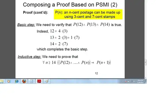

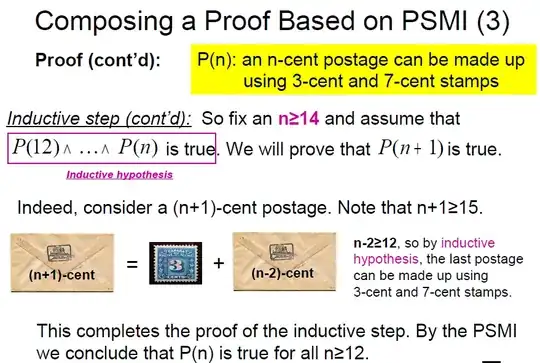

I am trying to understand this example of strong induction. I know normal induction. In normal induction, if base case is true then we assume some number $n$ to be true. Afterwards, we prove $n+1$ is true.
In strong induction, as you can see below, you prove more than 1 base case. I am not sure why. Then you prove $n+1$ is true...
I don't know why or how they choose however many base cases to prove or why proving extra base cases matters. Could someone please explain the inductive step of $3 + n - 2$? Where did it come from?

Here, the proposition being proven is:
Either $n\lt 12$, or else an $n$ cent stamp can be made using only $3$- and $7$-cent stamps.
The strong inductive step is:
Assume that the result is true for all $k$ strictly smaller than $n$. Then it holds for $n-3$; we can make an $n-3$-cent stamp using $3$- and $7$-cent stamps. Then we can make an $n$-cent stamp by making an $n-3$-cent stamp, and adding a $3$-cent stamp. So we can make an $n$-cent stamp. QED
The problem is that this argument works if $n$ is "sufficiently large", but it does not work if $n\lt 12$ (because that is not what we need to prove for $n\lt 12$) and it does not work if $n=12$, $n=13$, or $n=14$, because then $n-3\lt 12$, so our inductive hypothesis does not guarantee that we can make an $n-3$-cent stamp (the proposition "works" for any $n\lt 12$ by default). So the argument above is not complete. We still need to make sure everything works for $n\lt 12$, $n=12$, $n=13$, and $n=14$. By "everything works", we mean "if the proposition is true for all $k$ strictly smaller than $n$, then it holds for $n$.
If $n\lt 12$, then this is true simply because the proposition is true for $n$, so the consequent is true.
If $n=12$, this is true because we can verify that we can make a $12$-cent stamp (four $3$-cent stamps). So the implication is true because the consequent is true.
If $n=13$, the implication is true because the consequent is true: we can make a $13$-cent stamp (a $7$-cent stamp and two $3$-cent stamps).
If $n=14$, the implication is true because the consequent is true: we can make a $14-$cent stamp (two $7$-cent stamps).
And if $n\geq 15$, the argument we had before already worked.
So now we have established the strong inductive step for every positive integer $n$, and so by strong induction we have established the desired proposition for all positive integers.
(The $3+n-2$ came from applying the inductive argument to $n+1$).
