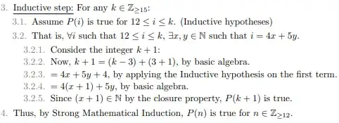

Induction Step(included after a comment by fleabloods):
Screenshot of inductive step

  • Well, the authors explanation was about why they needed to to the extra base cases because the induction step wouldn't work. We need to see what the induction step was to see why it wouldn't work. – fleablood May 30 '20 at 07:26
  • See... so not the step from 3.2.2. to 3.2.3. The author is assume that because it is true for $12\le i \le k$ then it is true for $k-3$. ... But that assumes $12 \le k-3$. Since $12,13,14 - 3 < 12$ we can't use the induction step yet. We can start using the induction step at $n=15$. It MIGHT have be easier to say: Let our base case be $n=15$. The let $n=12,13,14$ be "sub-base cases". Then if we assume it is true for all cases $k-3 \le i\le k$ we can show it is true for $k+1$. – fleablood May 30 '20 at 15:05

Your understanding of base case is incorrect. The base cases are simply those cases needed to provide a sufficient foundation for the induction step.
Here the induction step to prove that $P(k+1)$ is true relies on knowing that $P(k-3)$ is true: if there are $x,y\in\Bbb N$ such that $4x+5y=k-3$, then clearly $$4(x+1)+5y=k+1\;,$$ where $x+1,y\in\Bbb N$, so $P(k+1)$ is true. If we’ve verified only that $P(12)$ is true, that argument won’t tell us that $P(13)$ is true: in that case $k=12$, so $k-3=9$, and we’d need to know that $P(9)$ is true in order to use that argument. But as your source says, we didn’t verify that $P(9)$ is true, so that argument simply isn’t valid.
As it happens, $P(9)$ is true, so if we’d checked it as a base case, we could have used the induction step to see that $P(13)$ is true. $P(10)$ is also true, so we could have verified it as part of the base case and used the induction step to see that $P(14)$ is true. But $P(11)$ is not true, so there is no possible way to use the induction step to derive $P(15)$. It turns out that $11$ is the last failure: $12$ is the smallest integer such that $P(n)$ is true for it and every larger integer.
The induction works only after we know that $P(n)$ is true for four consecutive integers $n$: if $P(n)$, $P(n+1)$, $P(n+2)$, and $P(n+3)$ are true, the truth of $P(n)$ allows us to use the induction step to prove that $P(n+4)$ is true, the truth of $P(n+1)$ allows us to use the induction step to prove that $P(n+5)$ is true, and so on. But we need those four consecutive integers: if $P(n)$ and $P(n+1)$ were true, but $P(n+2)$ were not, the induction step would give us the truth of $P(n+4)$ and $P(n+5)$, but not the truth of $P(n+6)$, because for that we’d need to know that $P(n+2)$ was true.
Thus, the induction argument in this example really does use all four parts of the base case, $P(12)$, $P(13)$, $P(14)$, and $P(15)$: without them, the argument falls apart at one of the next four cases.

You didn't include what the induction step was!
We can't evaluate their argument if we don't know what the induction step was.
But from their commentary I suspect the induction step is something like:
If it is true for $n$ and for all values between $12$ and $n$ then it should be true for $n-3$ (assuming $n-3$ is between $12$ and $n$); then $n-3 = 4x + 5y$ for some $x,y$. So $n+1 = 4(x+1) + 5$.
But what's wrong with that?
Let's try it on $12$. Let's try to go from $12$ to $13$. It is true for $12$ and for all values between $12$ and $12$. So it should be true for $12-3=9$ (assuming $12-3=9$ is between $12$ and $12$) and ..... ....!!!!skreech!!!!!.....
NO! $9$ is not between $12$ and $12$ so we can't use the induction step.
Okay we'll can figure out a special case for $13$. So we now have that is it true for all $13$ and all numbers between $12$ and $13$.
Let's try to use the induction step to go from $13$ to $14$. It is true for $13$ and for all values between $12$ and $13$. So it ought to be true for $13-3=10$ so long as $10$ is between.... Oh G#@%!
So we do a special case for $14$.
But, lord, how long can this go on?! How many special cases will we have to do before we can do the induction step and never worry about special cases?
Well, we can do our induction step if we can assume that $n-3$ is between $12$ and $n$. But for $n-3$ to be between $12$ and $n$ we must have $n$ at least $15$. So we can't use our induction step untill we have gotten to $15$
So we need special base cases for $12,13,14$ and $15$.
