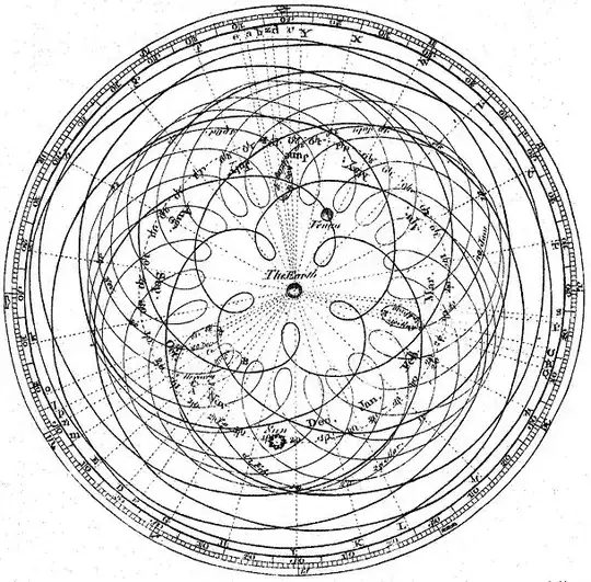

The ancient Greeks had a theory that the sun, the moon, and the planets move around the Earth in circles. This was soon shown to be wrong. The problem was that if you watch the planets carefully, sometimes they move backwards in the sky. So Ptolemy came up with a new idea - the planets move around in one big circle, but then move around a little circle at the same time. Think of holding out a long stick and spinning around, and at the same time on the end of the stick there's a wheel that's spinning. The planet moves like a point on the edge of the wheel.
Well, once they started watching really closely, they realized that even this didn't work, so they put circles on circles on circles...
Eventually, they had a map of the solar system that looked like this:
This "epicycles" idea turns out to be a bad theory. One reason it's bad is that we know now that planets orbit in ellipses around the sun. (The ellipses are not perfect because they're perturbed by the influence of other gravitating bodies, and by relativistic effects.)
But it's wrong for an even worse reason that that, as illustrated in this wonderful youtube video.
In the video, by adding up enough circles, they made a planet trace out Homer Simpson's face. It turns out we can make any orbit at all by adding up enough circles, as long as we get to vary their size and speeds.
So the epicycle theory of planetary orbits is a bad one not because it's wrong, but because it doesn't say anything at all about orbits. Claiming "planets move around in epicycles" is mathematically equivalent to saying "planets move around in two dimensions". Well, that's not saying nothing, but it's not saying much, either!

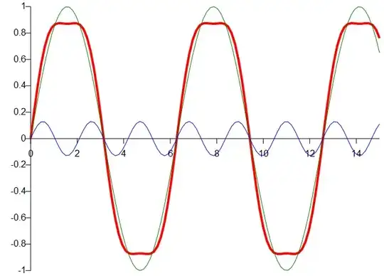

Take for example the red function from here
alt text
which is defined as
$$f(t) = \sin(t)+0.13\sin(3t)$$
The green oscillation with $\omega=1$ has the biggest impact on the result, so let's say $$\hat{f}(1)=1$$
The blue sine wave ($\omega=3$) has at least some impact, but it's amplitude is much smaller. Thus we say $$\hat{f}(3)=0.13$$
Other frequencies may not be present in the approximation at all, thus we would write $$\hat{f}(\omega) = 0$$ for these.

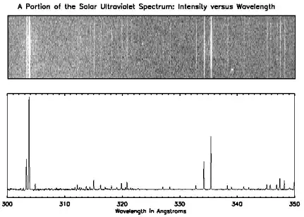

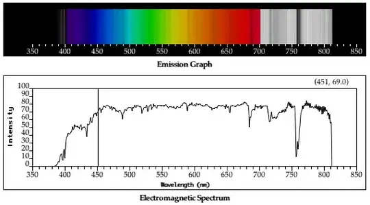

Think about light coming from stars.
spectrograph of the sun mass spectroscopy spectroscopy of, I think, the sun ultraviolet spectrogram of the sun
The light has colour or "spectrum" but of course the data comes in a 1-D stream.
The Fourier transform gives you the spectrum of the time series.

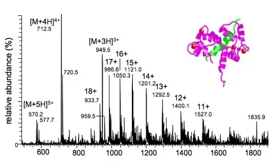

    That second figure (the one with the inset protein) looks like a mass spectrum. Most MS detection methods obtain a spectrum directly from a time-domain signal, although there are exceptions like fourier transform ion cyclotron resonance – Richard Terrett Mar 26 '14 at 01:49
  • That's right @RichardTerrett. That image isn't really so good as what I really wanted was elemental decomposition on stars, not proteins. Thanks fro pointing out the shortcoming. – isomorphismes Mar 28 '14 at 03:59
