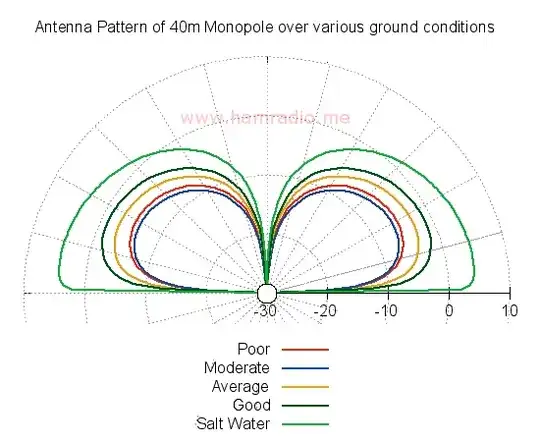

Here are some simulated results to illustrate, thanks to JSH:
simulated radiation patterns over ground planes of varying quality http://www.hamradio.me/wp-content/uploads/2016/01/40m_MonoPole_SXC.png
More radials, and longer radials, moves you closer to the ideal. Less radials, or shorter radials, moves you closer to a dummy load. If you have no radials at all then the feedline will be the radial and you end up with something not unlike a dipole (albeit a very oddly shaped one).

    The graphs above look hand drawn and are therefore questionable. Please simulate your ground mounted vertical antenna scenarios with something like NEC varying only the ground quality. You will likely find as ground gets worse, the vertical maintains roughly the same takeoff angle and pattern shape, but gain drops as ground absorbs energy. In fact, everyone should download 4nec2 and try for yourself. – JSH Jan 27 '16 at 02:36
  • Two radials 1/4 wavelength or shorter, and arranged opposite each other, have negligible effect on the azimuth pattern. Simulations and measurements confirm this behavior. See separate answer on this page for more details. – JSH Jan 27 '16 at 02:42
  • @JSH I look forward to seeing graphs in your own answer. – Phil Frost - W8II Jan 27 '16 at 09:58
    Here is a graphic showing the gain (dBi) of a 40m monopole over various grounds available in the 4nec2 "real ground" options. – JSH Jan 27 '16 at 19:22

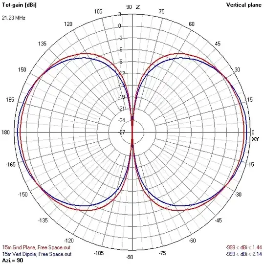

Below are NEC4.2 analyses showing the intrinsic, free space radiation patterns of (1) a ground plane antenna having two pairs of co-linear, λ/4, horizontal radials spaced at ±90°, and (2) a comparison of the free space elevation pattern of the ground plane antenna to that of a λ/2, center-fed dipole.
The λ/2 dipole has about 0.7dB more gain than the λ/4 ground plane, but otherwise their radiation patterns are very similar, and would be similarly affected by the propagation environment (e.g., reflections from the earth and/or other surfaces).
