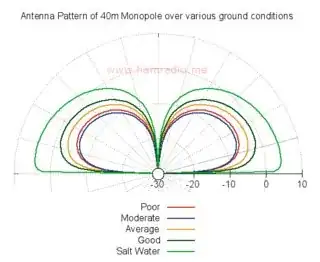

A typical gain pattern for a quarter wave ground plane antenna is:
Image from a similar question and see watermark.

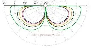

A naive response would be that the antenna's pattern would be unaffected except to be rotated 180 degrees, i.e.:

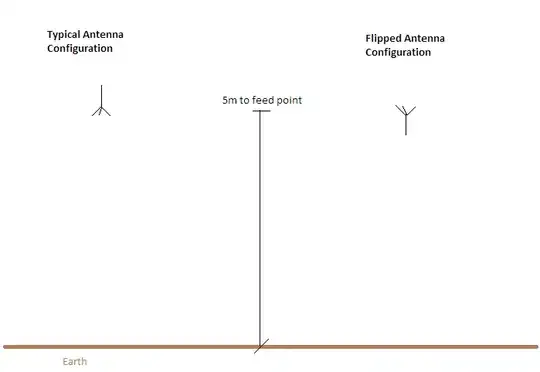

Simplified configuration for clarity:

  • @MarcusMüller I added a height to the question (5m), but that is kind of the point. Does the diagram flip so that everything is upside down? The only thing that changes about the antenna is that the radials are on the top and the vertical is on the bottom. The whole antenna is rotated to point down. – hazzey Jun 20 '16 at 13:25

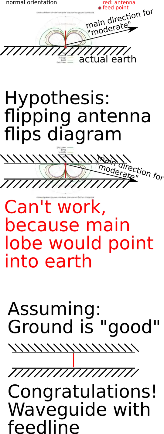

    I asked for a drawing for a reason :) Now, the diagram cannot flip, because then the main lobes would point down, but there's mother earth in the way. If you make a drawing, you'll notice that problem. – Marcus Müller Jun 20 '16 at 14:23
  • @MarcusMüller Added the diagram as requested. If you are saying that plot cannot be flipped because the earth has more to do with the gain plot than the location of the radials, then that sounds like an answer. – hazzey Jun 20 '16 at 16:12

    Just a point of information... my polar plots you reference are modeling ground mounted antennas, not antennas in freespace or above ground. – JSH Jun 21 '16 at 20:48

To answer this very graphically:
Flipping the diagram geometrically can't work:
Diagrams
What you've actually build is kind of a waveguide, consisting of two grounded planes below (earth) and above (virtual earth spanned by radials) your antenna; in this rotation-symmetrical setup, the H-field only exists in horizontal direction, and the E-field between the two planes will only exist vertically.
In other words: if we assume the virtual ground plane to be a perfect circle, then this looks like a lot of dipoles standing tightly next to each other between that plane's edge and the ground, being fed with exactly the same signal. Since this, for symmetry reasons, won't have any horizontal gain, the only gain we can have is vertical; but there's no vertical group factor in a group of horizontally shifted dipoles, so this will really just have the radiation pattern of a half-length dipole.
