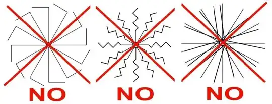

The most recent manual that was written with help from DX Engineering contradicts earlier versions of the manual regarding its advice for limited-space antenna installations. The manual now suggests that not bending the radials is the way to go. The manual also says that many short radials are better than a few long ones.
image capture from 6-BTV manual, showing various arrangements of bent radials with red X marks through them and "NO" in red

    In the manual of the Hustler http://www.radiomanual.info/schemi/ACC_antenna/Hustler_4-BTV_5-BTV_6-BTV_new_version_user.pdf on page 13 this kind of inductive radial is disadvised. The lowest inductance in lossy ground is obtained from straight line radials, eventually splicing in more lines at a distance from the center point, to have maximum coupling with the soil. Bending radials results in higher losses. –  Nov 28 '21 at 14:44
