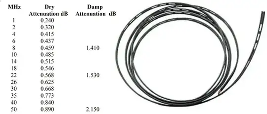

From DX Engineering's 300 ohm ladder line datasheet:
Compare the loss at say, 30 MHz: 0.7 versus 0.668 dB/100 ft. For practical purposes, the same. If the ladder line is wet, or running in proximity to other things, the loss is much higher.
Of course, not all ladder line is equal: there are examples both better and worse than this one. But the unqualified assumption that ladder line has lower loss is not true.
