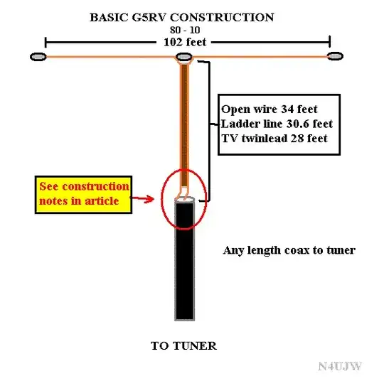

UPDATE This design is flawed, because the tuner does nothing to tune the impedance mismatch at the balun. As Mike Waters notes below, my drawing is basically a G5RV, with an separate wound 1:1 balun at the ladderline feedpoint. The G5RV looks like this:
Picture of G5RV

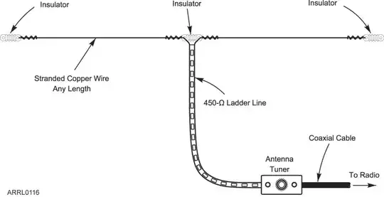

What I want is this, the random-length multiband dipole.
So it appears in conclusion that I do need a remote tuner at the base of the ladderline feed, or I need to bring the ladderline into the shack. Or, an alternative would be to go with Phil Frost's suggestion and use a folded dipole and operate it at its resonances. I think I probably want wider-frequency coverage than the resonances of the folded-dipole, so it sounds like the tuner + simpler wire setup is more optimal for my situation.

    I think you are getting off track with the edit. There's nothing about ladder line that makes it more suited to this application than coax except that it's relatively cheap and the losses are low for the price. Running ladder line all the way to the shack doesn't get you anything unless it's lower loss than the alternative. Look up the datasheet on the ladder line you'd like to use: it may not be better than LMR-400. And what do you mean by "the tuner does nothing to tune the impedance mismatch at the balun"? – Phil Frost - W8II Feb 03 '17 at 02:39
  • @PhilFrost-W8II thanks for the followup. The difference between drawing (a) and the ARRL drawing (c) isn't the use of ladderline or coax, it's the lack of a separate balun between the tuner and the antenna feedpoint ... right? Doesn't that balun create a separate impedance mismatch between the end of the coax and the ladderline in my original drawing (a)? Then the tuner is tuning the impedance at the input of the coax to 50 ohms but there may still be a ton of reflection where the balun meets the ladderline. Or am I not correctly understanding how impedance matching works? – bcattle Feb 03 '17 at 02:54
  • Yes, the coax and the ladder line aren't matched, but if you make that a 4:1 balun they will be. That said, it may be moot since it terminates into the dipole which is effectively a random impedance. The addition of another mismatch at the the coax/ladder line balun could make things better, or worse. See http://ham.stackexchange.com/a/7053/218 for an example of how a mismatched line plus a mismatched antenna can equal a matched system. – Phil Frost - W8II Feb 03 '17 at 03:16
  • Thanks, that's interesting. I guess you're isolating what's confusing to me: I have a dipole of random length. It has a random impedance. That random impedance is driven by 300 ohm open-wire feedline for low loss. (1) What is the impedance at the end of that line? I add a 1:1 balun. (2) Now what is the impedance at the input to the balun? Does it equal the impedance at the output of the balun? I.e. does the 1:1 in the balun description mean it is some sort of "transparent impedance passthrough"? Maybe this is an entirely separate SO question lol – bcattle Feb 03 '17 at 03:46
    Yeah. http://ham.stackexchange.com/q/7174/218 – Phil Frost - W8II Feb 03 '17 at 14:39
  • Running ladder line all the way from the feedpoint to a suitable tuner is a proven way to make a center-fed dipole work on all bands. I didn't suggest that before because you said that wasn't an option. – Mike Waters Feb 03 '17 at 15:10

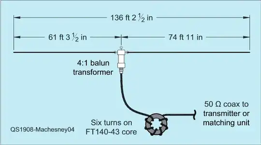

You might find some advantage to using a Slightly Off-Center Fed Dipole, as described in QST for September 2019. Feeding a single wire through a 4:1 step-down balun 45% from one end produces a usable match to 50-$\Omega$ coax on eight HF ham bands:
With low-loss coax like your LMR-400, the additional mismatch loss is quite low, allowing you to match the coax to the rig in the shack.
The antenna is simple to build:

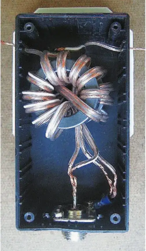

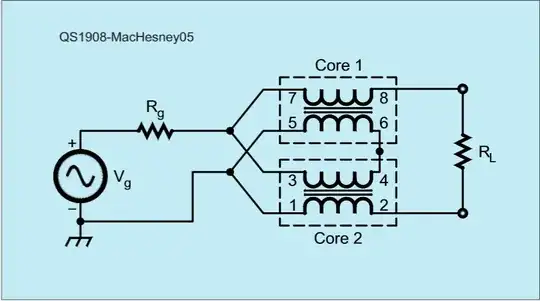

You may find that a slightly longer wire will give lower SWR if the antenna is mounted more than 30-feet above ground. Planning to run no more than 150-watts, I used speaker wire to wind a 4:1 Guanella balun:

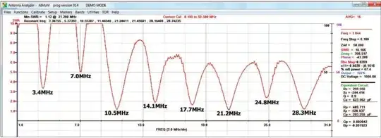

With the dimensions shown and the antenna mounted 30-feet above ground, I obtained this plot of the SWR at the junction of the coax and the balun:
I've received notes from dozens of satisfied builders of this antenna. I've used it for portable DXpedition and FD operations with good success.

Your design is a little like the G5RV. That took a lot of trial and error to make it work on several bands. Later, ZS6BKW used computer modeling software to fine-tune the G5RV. You would save yourself a lot of time and effort if you modeled this in EZNEC or a similar program.
Mike Waters
  • 7,948
  • 18
  • 51
  • Thanks Mike. Yeah I see your point, having the balun there does make this like the G5RV, which is not what I want. I want the nonresonant dipole-doublet mentioned in the Cebik paper. Thanks for the suggestion on modeling, I'll try that. If setting it up in EZNEC, would you model only the horizontal elements, or the ladder line as well? Thanks. – bcattle Feb 02 '17 at 20:40
