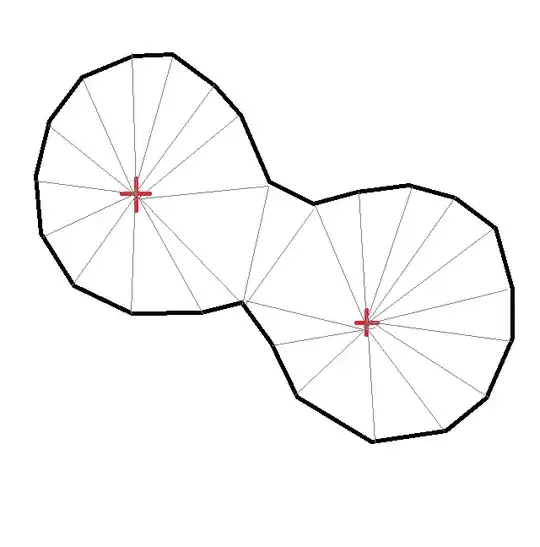

I want to simulate blobs of water in a 2d game in Unity3d. One possible way of doing it is to use 3d metaballs moving in a 2d plane though this is very processor intensive. Do you think it would be possible to make 2d metaballs, so I end up with a 2d meshes something like in the picture (In this case its 2 metaballs in conjunction) and then apply some kind of shader to make it look like they are bulging out and refracting the texture behind them like drops of water? I ask because I dont have much experience with shaders and am not sure what is possible.
please excuse terrible drawing!
