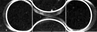

Below is a two droplet merging together,in 2d.
I want to simulate the behavior when I exert combination force(through mouse or fling force on touch screen) on one of them to make them to be a larger droplet.
I suppose there exists some kind of function by the distance of these two droplet's center,when the distance is closer,one becomes smaller,the other one becomes larger.
What kind of model should I build? Particles or geometry circles or sth else?
Two droplet merge

  • @Byte56 thanks.The post you have pointed has quite a lot on Unity3d and shaders and effects which is overhead and not necessary in my case.The key point I beg to know is the final contour shape during the process with user's interaction. – zionpi Jul 08 '15 at 14:22
  • That other question is fundamentally the same, and the solutions are language- and framework-angostic. A complete DX9 implementation won't be provided in any case. – Seth Battin Jul 08 '15 at 14:32
  • @zionpi Well, there are others: http://gamedev.stackexchange.com/questions/76120/2d-metaball-liquid-effect-how-to-feed-output-of-one-rendering-pass-as-input-to?lq=1 http://gamedev.stackexchange.com/questions/81361/surface-creation-algorithm-using-points-cloud?lq=1 Basically the answer is metaballs. – House Jul 08 '15 at 14:33
