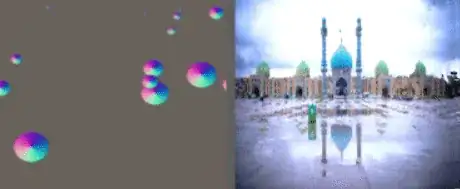

I'm trying to make rain effect drop with metaballs and trail on screen.I find a clue in shadertoy but I didn't understand how implemented:
https://www.shadertoy.com/view/ltffzl
unfortunately it have many math calculations and i can't use it in unity because it produces a lag.obviously I should use textures but how can I have trail effect?!
my idea is using a texture and trail renderer for droping but how can I have metaballs effect? enter image description here
Update
I could Implement Metaballs by This Article
https://github.com/smkplus/RainFX/tree/master
but I haven't Idea about trail

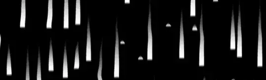

I think you should think about the effect as "calculate a map of where the water is" + "generate a normal vector from that map and use it to offset a background texture lookup".
Breaking down what your example shadertoy does, it just calculates a "trail" to show where the defogging happens:
Calculates the normals of the circular raindrops,
and uses that normal map to offset a texture lookup to fake refraction.
If you want the trails done via post-processing in a shader, you should just create the "trail" shape in the shader using some algebra. For example, in the following function, I've overlaid a "wobbly path" and a taper at the head and tail to get
float trailDrop(vec2 uv, vec2 id, float t) {
    // wobbly path
    float wobble = 0.5 + 0.5
        * cos(120.0 * uv.y)
        * sin(50.0 * uv.y);
    float v = 1.0 - 10.0 * abs(uv.x - 0.5 + 0.2 * wobble);
    // head
    v *= clamp(30.0 * uv.y, 0.0, 1.0);
    v *= clamp( uv.y + 7.0 * t - 0.6, 0.0, 1.0);
    // tail
    v *= clamp(1.0 - uv.y - pow(t, 2.0), 0.0, 1.0);
    return clamp(v * 10.0, 0.0, 1.0);
Here's a rough POC in shadertoy -- https://www.shadertoy.com/view/XlBfz1 demonstrating creating a set of raindrop trails. It looks grainy at small resolutions due to the derivatives resolution but should look better if you fullscreen it.
Edit: Added an example with overlaid raindrops
Left as an exercise to the reader:
1) Add the small round drops. for inspiration, look at the StaticDrops function in your original shadertoy example.
2) Add in high-quality normal calculations. As the #define CHEAP_NORMALS option in your original shadertoy example implies, the builtin dFdx is a low-fidelity approximation and you can get better results by manually calculating the derivatives (at the cost of calculating the function 3 times).
3) Randomizing the spacing between the columns. You can widen the columns and then modify the uv.x - 0.5 + 0.2 * wobble bit to add a random offset on the x axis. You'll also probably want to take a page out of the original example once again and layer a couple different sized layers of streams on top of each other to get a less uniform look.

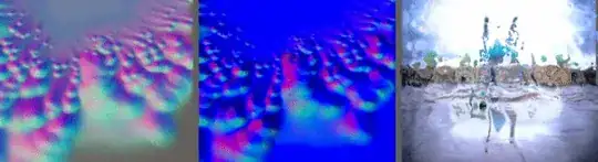

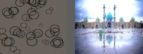

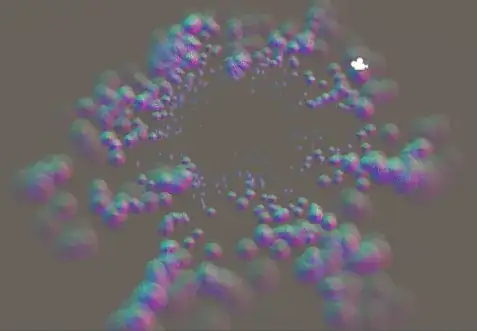

you can make this effect by following the steps below:
Particle
Particle
RenderTextuer
you can store result by using RenderTexture. this is example of multipass in shadertoy:
https://www.shadertoy.com/view/ltccRl
iñigo quilez: Shadertoy uses multiple passes, one per "Buffer". As the name indicates, this passes store the results in a buffer. A buffer is just a texture. Unity will let you render to textures too.

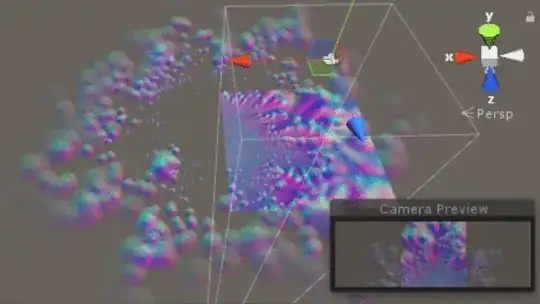

I created a camera to Rendering particles to RenderTexture:
ax
RenderTexture
GrabPassing
you can grab pass for applying Distortion
I explained it in this post:
How can I replicate Quantum Break's distortion particle effect?

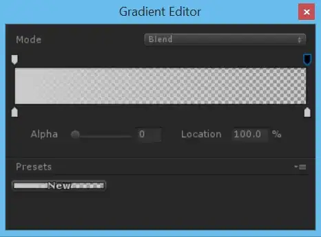

Blur
by using alpha in color over Lifetime we have simple blur
alphaovertime
gradiant
to get better result it's better to use simple blur , but how we achive blur?

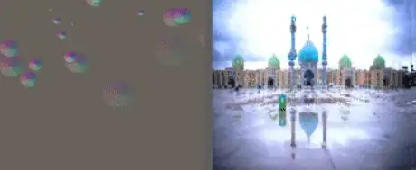

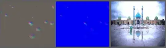

you can use Rendertexture to store previous frame.so you can grab previous frame then blur. by repeating this you achieve blur.
0fe28c6167db2132d4bb8677fc1b2050--leandro-erlich-argentina

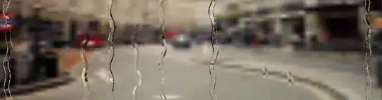

Normal
float4 distortion = tex2D(_MainTex,i.uv);
float3 distortionNormal = UnpackNormal(distortion);
record_2019_03_03_21_35_45_417
Conclusion
Final shader:

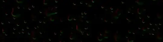

without using alpha in color over Lifetime:
record_2019_03_03_21_48_36_273
by using alpha in color over Lifetime:
record_2019_03_03_21_48_19_786
