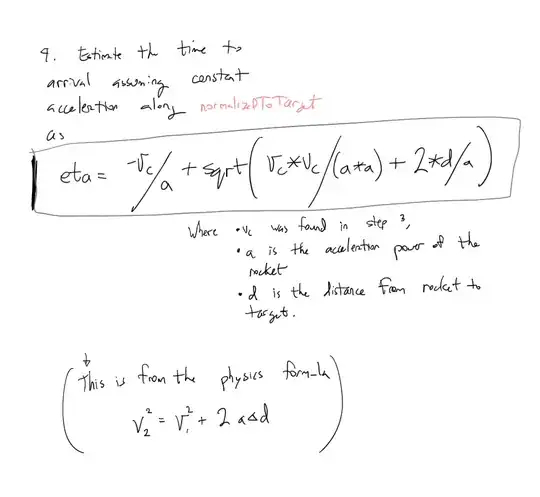

What you have to do is estimate the future position of the moving target and steer towards that.
Here is bobobobo's super 5 step simplified process
1. Initial picture of the system.
2. Really what we are doing here is subtracting the rocket's velocity from both bodies in the system, so the rocket is effectively "stationary", and the target is moving
3. vc is really the scalar speed at which the gap between the 2 bodies is closing.
4. Must not have a=0! If a=0, then eta=inf, which makes sense
Derivation of eta: Sorry, I lied in the image above. The eta= formula comes from:

  • Alright here's what I understood: Let the Vrt vector be the target's speed - the rocket's speed; I create an acceleration towards the target; I estimate the time it'd take to arrive at the target with the rocket's speed being -Vrt and the aforementioned acceleration; I estimate the location of the target after the elapsed time with target's speed being Vrt; I aim my acceleration towards this location. I hope I got your writing right! c: – Mutoh Apr 09 '13 at 01:27
  • I think OP is aware of this solution; it's mentioned as the "Arrival" behaviour. – congusbongus Apr 09 '13 at 01:28
  • Pretty much! If what you're chasing has an acceleration of it's own, you'll get this neat "miss" behavior if the target is "evasive" enough. – bobobobo Apr 09 '13 at 02:28
