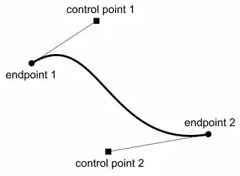

I implemented a bezier curve script that takes as input a list of waypoint and tangent handle Vector3 (Tangent handle is angle at point + weight which is represented by the length of the handle) which I plan to use to move the aircraft alone but I have not figured out a good algorithm to determine where to move to and the tangents at those points.
http://www.webreference.com/dlab/9902/f1.gif
The control points in the img above are the same as my tangent handles.
