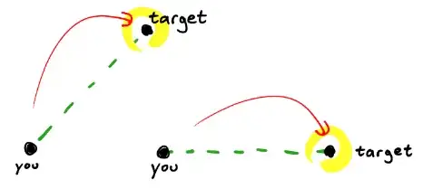

Here's one way: Let's rotate your diagram.
a rotation of the original problem illustration
Now the rocket is a cannonball!
Physics
It has a fixed acceleration "downwards" i.e. perpendicular to the vector from its firing location to its target. I drew it above as a dashed green line. Let's call that the reference horizon. (Note that this reference horizon is constant! The rocket was fired from a fixed position with a fixed position as a target.)
We know (from wikipedia) for a cannonball without air resistance, that d = v^2 * sin(2 * theta) / g, where
  • d is the horizontal distance travelled (distance between firing location and target)
  • v is the speed the projectile was fired at
  • theta is the angle as to the horizon the projectile was fired at (angle of fire direction vector from the reference horizon)
Rearranging the equation for g gives g = v^2 * sin(2 * theta) / d.
The constant in the cannonball equation, g, is acceleration due to gravity. We can take it to mean acceleration due to rocket propulsion. That's fine too — it's still a constant acceleration in a constant direction.
Now what?
Run that equation for g when you fire the rocket. It will tell you how much to accelerate the rocket perpendicularly toward the reference horizon, in order to hit the target. Since the direction of that acceleration is constant, an orbit won't form.
Boom.

  • This is a neat approach. I think this is going to cause the rocket to trace a circle, you are supplying the centripetal force required to orbit a circle that happens to impact the target. I believe this may have been the approach used for red shells in Mario Kart, because I always thought they tended to arc circularly – bobobobo Dec 15 '12 at 02:41
  • The force applied here is not centripetal. The direction of the force is perpendicular to the reference horizon, which does not change if the target is stationary. This means orbiting behaviour cannot happen. – Anko Dec 15 '12 at 10:15
  • I've edited the answer to make that clearer. – Anko Dec 15 '12 at 10:32
  • @Anko: I'm not certain your math here works for a moving target, as seems to be the trigger for the OPs case. – Mooing Duck Dec 23 '14 at 17:39
  • @Mooing You're right this would only work for moving targets if they're moving predictably and you target the prediction. The question does specifically mention the target is stationary though, in the first sentence. – Anko Dec 24 '14 at 00:32
  • @Mooing " works fine as long as you are not strafing" sounds to me like it's the player moving, not the target. – Anko Dec 24 '14 at 02:09
  • Oh! I thought the player was the target. This code works for the case in the question then. – Mooing Duck Dec 24 '14 at 09:47
