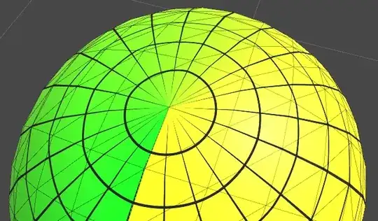

But at the end of the day the mesh is made of only so many triangles, so there are places where it can't perfectly follow the latitude/longitude mapping. At the top of the sphere you can see there are notches cut out, making a zig-zag: parts of the texture space get skipped over. That leads to some noticeable distortions at the poles:
Pole distortion
As I explain in this answer, this is a limitation of affine texture mapping in general. Lines are only able to change directions at triangle edges, so it can't represent a smooth curving of a non-linear mapping inside an individual triangle. And an equirectangular projection (latitude-longitude) gets highly non-linear at the poles!

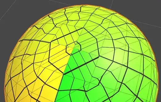

And now we get a proper non-linear mapping, with no more distortion at the poles, or zig-zagging where lines cross triangle boundaries:
Pole distortion corrected
