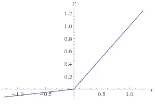

As @Neil Slater mentioned, a fix is to modify the flat side to have a small gradient, so that it becomes $ReLU=max(0.1x,x)$ as below, which is called LeakyReLU. enter image description here

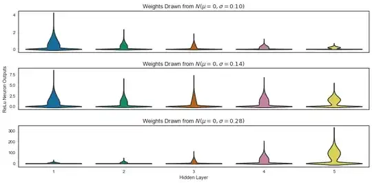

ReLU neurons output zero and have zero derivatives for all negative inputs. So, if the weights in your network always lead to negative inputs into a ReLU neuron, that neuron is effectively not contributing to the network's training. Mathematically, the gradient contribution to the weight updates coming from that neuron is always zero (see the Mathematical Appendix for some details).
What are the chances that your weights will end up producing negative numbers for all inputs into a given neuron? It's hard to answer this in general, but one way in which this can happen is when you make too large of an update to the weights. Recall that neural networks are typically trained by minimizing a loss function $L(W)$ with respect to the weights using gradient descent. That is, weights of a neural network are the "variables" of the function $L$ (the loss depends on the dataset, but only implicitly: it is typically the sum over each training example, and each example is effectively a constant). Since the gradient of any function always points in the direction of steepest increase, all we have to do is calculate the gradient of $L$ with respect to the weights $W$ and move in the opposite direction a little bit, then rinse and repeat. That way, we end up at a (local) minimum of $L$. Therefore, if your inputs are on roughly the same scale, a large step in the direction of the gradient can leave you with weights that give similar inputs which can end up being negative.
In general, what happens depends on how information flows through the network. You can imagine that as training goes on, the values neurons produce can drift around and make it possible for the weights to kill all data flow through some of them. (Sometimes, they may leave these unfavorable configurations due to weight updates earlier in the network, though!). I explored this idea in a blog post about weight initialization -- which can also contribute to this problem -- and its relation to data flow. I think my point here can be illustrated by a plot from that article:
Activations in a ReLU MLP with different initialization strategies
The plot displays activations in a 5 layer Multi-Layer Perceptron with ReLU activations after one pass through the network with different initialization strategies. You can see that depending on the weight configuration, the outputs of your network can be choked off.
