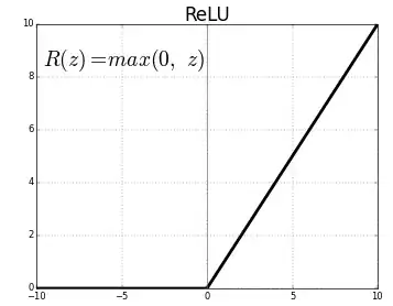

The main reason to use an Activation Function in NN is to introduce Non-Linearity. And ReLU does a great job in introducing the same.
Three reasons I choose ReLU as an Activation Function
  • First it's Non-Linear( although it's acts like a linear function for x > 0)
  • ReLU is cheap to compute. Since it's simple math, model takes less time to run
  • ReLU induces sparsity by setting a min value of 0
