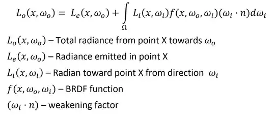

I am trying to implement BRDF microfacet path tracing and I think I need a little push. I will explain what I understand so that you can correct my mistakes.
I start with simple rendering equation: enter image description here Le and Li are radiance we have no control of so I cannot change anything about them. The only thing I can change is function F which is called BRDF. Specifically, I am using this Cook-Torrance microfacet specular BRDF I found here. enter image description here For functions F, G and D I choose these formulas. enter image description here

  • The integral of the microfacets distribution is NOT over the hemisphere. It is over the area of the surface. The cosine term is related to the projected areas of the microfacets. and the integral basically says that the sum of projected areas of microfacets must equal the surface area. – ali May 04 '20 at 04:29
  • Have a look at pbrt here somewhere in the middle of the page has the diagram: http://www.pbr-book.org/3ed-2018/Reflection_Models/Microfacet_Models.html – ali May 04 '20 at 04:29
