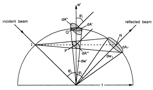

For a nice explanation of the term, you should check [Nayar, 91], appendix D. Here is an image from the same paper:
$$ d\omega' = \frac{d\omega_r}{4\cos{\theta_i'}} $$
Also, Joe Stam agrees with Nayar's $\frac{1}{4}$ term in [Stam 01, An Illumination Model for a Skin Layer Bounded by Rough Surfaces] , appendix B.
