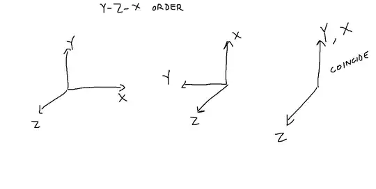

EDIT:- To make it more clear I've also heard about rotation orders like in the order Y-Z-X when Y axis rotates then Z and X rotate with it but when Z rotates only X rotates with it. thus making the axes non-orthogonal. I am assuming that's what it means by non-orthogonal mentioned in the wiki article. Here is a picture.
As you can see in the Y-Z-X order, the Y axis remains there as in 3rd picture causing the axes to coincide...

So thanks to joojaa I finally got a hint, and I searched on the net further and found this link which cleared all the doubts and has my answer. Though I am still posting it here as a summary.
So anyone reading this and who has similar problem to mine here is what I understood. Suppose we are considering the tait-bryan angle order X-Y-Z that is rotate first along X then Y and finally Z. Also to make it clear we are rotating around the "fixed" axes since a rotation matrix always rotates around the fixed axes. The matrix doesn't know anything about the axes moving or anything.
So suppose I have my initial frame like in my picture (original post) leftmost. If I use Ax with angle = 90 degrees then my Y axis becomes Z and Z becomes -Y. However if I now rotate with Ay the matrix will still be rotating around the previous/original fixed Y axis.
Now that's clear take this plane as an example. We want to rotate in the order X-Y-Z. enter image description here
If we rotate around the X-axis we can see that the plane will either roll left or right. Suppose we rotate a little around the X-axis and then rotate around Y-axis so that it is pointing straight up like this
Now we have to rotate around Z as this is the last in the order. But notice that the rotation around Z is similar to the previous rotation we performed around X. The plane will roll either towards the left or right. This means we lost 1 degree of freedom. I think this is what joojaa was trying to explain to me. So everywhere where people are saying the axis coincide its the local, moving frame coinciding with the original frame. Initially both the local and global frames are coinciding. In this case when we rotated around Y by 90 the local moving X-axis collapsed on to the fixed original Z- axis causing this gimbal lock
