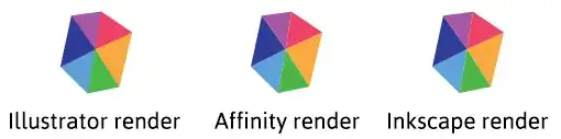

Here are three renders of the same vector graphic in Illustrator, Affinity and Inkscape. (The image produced in Affinity and Inkscape are exactly the same.)
Images rendered in popular graphic editing tools
As you can see there is an undesired white line on each of the edges in the image rendered with Affinity and Inkscape. The anti-aliasing does not fill this area with a solid color which results in a small gap between adjacent shapes.
Although there is no gap in the Illustrator render, the edges of the shapes look as smooth as the Affinity render.

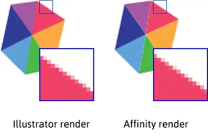

Here is an image showing the same area of each image upscaled.
Upscale render showing anti-aliasing
There is a very subtle difference between the two images. The Affinity render is a tiny bit smoother but it is almost impossible to see the difference when looking at the images in their original sizes.

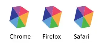

Browsers
SVG rendering
Displaying the same graphics exported as SVG in a browser looks very similar to the raster image produced by both Affinity and Inkscape.
SVG file rendered in browser
There are very tiny differences in edges anti-aliasing (that are not really worth showing here) but SVG rasterization in common browsers behaves pretty much the same.

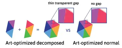

Testing Illustrator rendering a bit further, I tried splitting parts of my graphics and exporting them individually then composing them back together with a raster editing software.
Image recomposition scheme
In theory it would result in the same image as having it in a single piece, but the result is slightly different using this method.
Result of recomposed image
As shown, when the two parts are composed, there is a tiny gap between them. Though it is more subtle, it is very similar to the graphic rendered in Affinity.

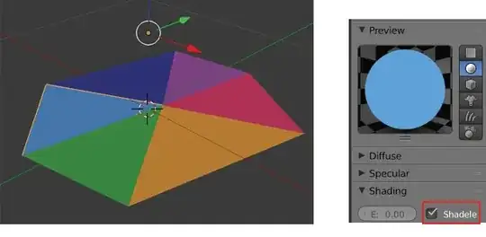

Blender allows you to import SVG files and manipulate them as curve objects. Here is the imported graphic shown in the 3D viewport. (By default material will be affected by lights in the scene. Checking the shadeless property in the material property panel will allow the shapes to be rendered with their original colors.)

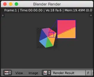

Here is a render made of the SVG inside Blender.
Actual render in Blender
It does not have any gap between the triangles. Other 3D softwares are very likely to work the same way. So Blender behaves just like Illustrator, or does it? Maybe it is the other way around?

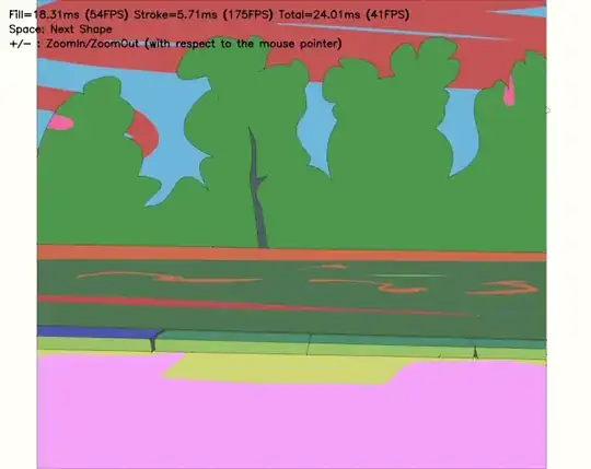

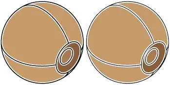

And just to add: it is called "conflation" artifact and this is what AntiGrain Geometry used the compound shapes rasterizer for, see:
(source: sourceforge.net)
Also, this is what NV Path Rendering claims to improve on:
An Introduction to NV_path_rendering (p. 67) or NV_path_rendering FAQ (#29).
