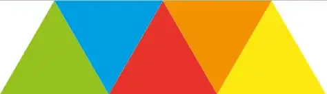

Image 2: Suppose you have this scene, exploded view on right
Now you can not just do this analytically, each piece separately and then merge the data. Because it results in wrong data. See alpha blending would let the blue shine trough the gaps if you did so.
What you have to so is split the scene up so that each shape eliminates what is under the other:
Image 3: You need to cut the underlying surfaces.
Now if everything is opaque then this is all straight forward. just calculate the area of each piece and multiply that by color and sum them together. Now you can use something like this.
This all breaks down if your individual shapes aren't opaque off course but even that can be done at some level.
