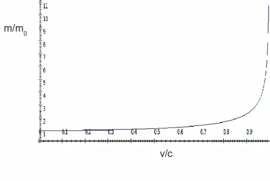

(2) The relativistic mass of an electron is given by:
$$m_\mathrm{rel} = \frac{m_\mathrm{e}}{\sqrt{1-\left(\frac{v_\mathrm{rel}}{c}\right)^2}}$$
where $m_\mathrm{e}$, $v_\mathrm{rel}$, and $c$ are the electron rest mass, the velocity of the electron, and the vacuum speed of light, respectively. The following figure provides a graphical representation of the result.
mass ratio vs speed of light
(3) The following equation relates the ratio of the relativistic radius of the first Bohr orbit $R_\mathrm{rel}$ to the normal radius $R_\circ$, to the relativistic velocity of the electron:
$$\frac{R_\mathrm{rel}}{R_\circ} = \sqrt{1-\left(\frac{v_\mathrm{rel}}{c}\right)^2}$$
As the relativistic velocity of the electron increases, the orbital radius contracts (the above ratio becomes smaller). For silver, the first Bohr radius contracts ~6%, while for gold the contraction is ~18%.
