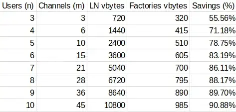

Let's assume we have a bunch of users who all want to open payment channels to each other. For n users, they need to open m channels where m = n(n-1)/2. For current-generation Lightning Network channel open, they'll probably spend at least two inputs and generate at least three outputs (about 240 vbytes times m channels). For a channel factory, they'll have about n inputs (at 70 vbytes) and n + 1 outputs (at about 25 vbytes) plus 10 vbytes overhead. Here's the savings accounting:
This doesn't count channel closing costs, which are harder to calculate since channels may remain open for variable lengths of time. Also not included is the additional savings available from Schnorr signature aggregation---if that should be activated on Bitcoin, it will increase Channel Factory efficiency moderately by decreasing the amount of space used by the inputs. Please note, numbers used here are a rough approximation.
Note that although channel factories provide significantly lower costs even for small numbers of participants, where they really excel is at making it cheap to build a dense web of payment channels between users. This will likely significantly improve the quality of service of a widely-distributed Lightning Network by ensuring most paths from spender to recipient stay short, which helps the widely-distributed network further effectively compete with a more centralized network that has short paths between large hub-like entities.
