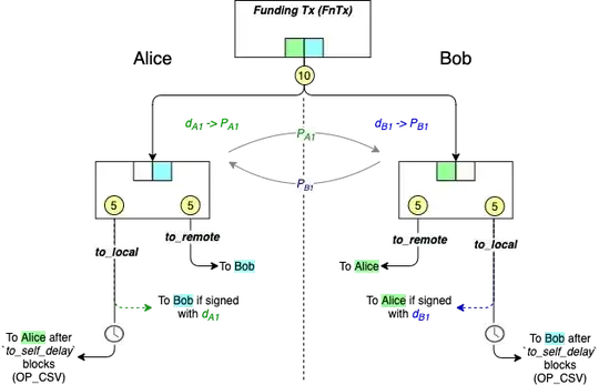

When two channel participants open a channel or update it, they exchange commitment transactions. These commitment transactions allow each party to unilaterally close the channel.
The commitment transactions are asymmetric in that they lock the closing party's funds when broadcast, i.e. Alice's commitment transaction locks Alice's funds, Bob's commitment transaction locks Bob's funds. The counterparty's funds are immediately available for spending. The lock on the closing party's funds (the "breach remedy") gives the counterparty time to impound the closing party's funds via a "punishment transaction" if an outdated state was broadcast.
Illustration of the asymmetric commitment transaction
Commitment Transaction (via Elle Mouton): Alice's output to herself (to_local) in her commitment transaction is encumbered with a Revocable Sequence Maturity Contract (RSMC) which allows her to revoke the commitment transaction later, while the output to Bob (to_remote) is a simple send, vice versa for Bob's transaction.
When a payment is made in the channel and the channel is updated with new commitment transactions, the outdated channel state is revoked by revealing the secrets to spend the old commitment transactions (dB1 and dA1 in the graphic). This makes the old state "toxic" in the sense that (accidentally) using the outdated commitment transaction to close the channel will cost the closer all their funds in the channel.
