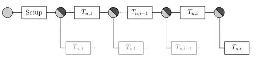

The Decker-Russell-Osuntokun update mechanism (“Eltoo”) manages to ratchet the channel state forward without asymmetry. Instead of having a separate commitment transaction for each party, a symmetric Update Transaction is created for each new channel state shared by all parties. Update Transactions tie only to the scriptPubKey and amount of a prior transaction output instead of a specific outpoint (which requires SIGHASH_ANYPREVOUT). Each Update Transaction spends the output of the Setup Transaction or any Update Transaction older than itself. All Update Transactions share the same input amount and pay the same output amount to the same scriptPubKey. The payout to the channel owners happens only in a later Settlement Transaction which can only be used after the corresponding Update Transaction has a number of confirmations (via OP_CHECKSEQUENCEVERIFY). This gives other channel owners time to submit any newer Update Transactions if an outdated Update Transaction was published.
A UML diagram showing the state transitions in an Eltoo channel. The initial state is followed by a Setup Transaction. The Setup Transaction either can be spent by Update Transaction 1 (or higher), or Settlement Transaction 0. Update Transaction 1 in turn can be spent by Update Transaction 2 (or higher) or Settlement Transaction 1.
via eltoo: A Simple Layer2 Protocol for Bitcoin
There is no punishment for the publication of an outdated state. However, the Update Transactions itself do not pay any fees since input amount and output amount are the same. The publisher must add another input to provide fees (and possibly another output to reclaim change). However, while an older Update Transaction is in the mempool or even after it has already been included in a block, newer Update Transactions can be submitted to enforce a more beneficial outcome for other channel owners (or to skip directly to the newest Update transaction). An unsuccessful attacker wastes the transaction cost of broadcasting an outdated state when their transaction confirms but is later superseded.
Since the channel state is symmetric and there is no state specific breach remedy, each (honest) channel owner needs only the latest state which reduces the amount of state channel owners need to keep track off. Old channel backups are no longer toxic waste that immediately trigger loss of all funds. In case of an actual data loss, other channel owner can ratchet forward to any later state (which may still lose the negligent channel owner some or all funds, or may be the latest state in the case of an honest counterparty). Since the channels are symmetric, the overhead of having multiparty channels is linear. It may still be impractical to create channels with numerous channel owners, since each channel owner must sign every Update Transaction, but a handful channel owners should be feasible. The overhead for updating the channel state may also be somewhat mitigated via Channel Factories which allow subsets of the channel owners to have segregated balances they can update among themselves.
