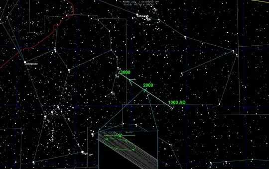

One hypothetical path through the sky of Planet Nine near aphelion crossing Orion west to east with about 2,000 years of motion. It is derived from that employed in the artistic conception on Brown's blog.
