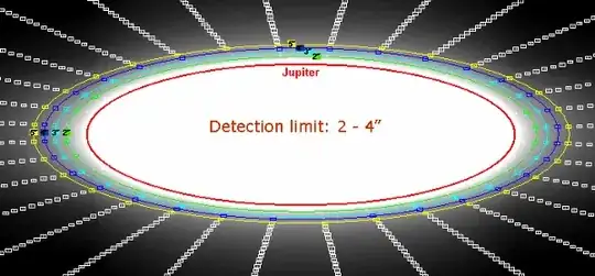

This site describes the detectability of stars near Jupiter (relative to Gaia's view), where "the detectability is a function of the star angular position with respect to Jupiter." The image at this site is helpful, enter image description here which shows the detection limits "for a star of magnitude G = 13.5 as it gets close to Jupiter in a wide range of relative orientations... Jupiter has an elongated shape because the Gaia pixels are rectangular, with a size three times smaller in the x-axis direction. The detection limits found for a G=13.5 star close to Jupiter are between 2" to 4"."

  • +1, but one correction note: "Jupiter has an elongated shape because Gaia pixels are rectangular" - no, but because the main mirrors of Gaia telescopes are rectangular. There are two identical telescopes on Gaia, with main mirrors of size 1.45 x 0.5 meters. So PSF (point spread function) of the telescopes is more elongated in the direction of shorter dimension. And the pixels of Gaia are manufatured rectangular because of this. – Heopps May 19 '23 at 07:29
