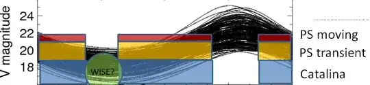

Here's the authors' summary:
Estimated 9th planet orbit
Estimated orbit for the putative 9th planet. The horizontal axis is the right ascension. The colored segments are regions where it should have been found by existing surveys.
Illustration by Brown and Batygin, assuming fair use applies.
The biggest unexplored territory is where, statistically, it is most likely to be: near aphelion. Sadly, aphelion is also very close to the Milky Way galaxy. Ugh.
So where is it? Probably distant. 500 AU+. Probably fainter than 22nd magnitude. Very possibly in the middle of the Milky Way galaxy.

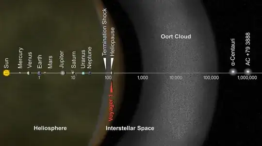

Finally, the gravitational dominance of the Sun reaches halfway to the nearest star. There's still plenty of unexplored territory for planets smaller than Saturn to hide in.
Solar system distances out to the Oort cloud and beyond
Note the log axis. We have a good map for the inner 50 AU, and are starting to find objects around 100 AU, but solar system objects might exist all the way to the outer edges of the Oort cloud.
Illustration from wikipedia.
j-g-faustus
  • 1,301
    The current dominance of the Sun might extend half-way to the nearest star now, but statistically we come close to other stars frequently, maybe a light year or closer, which could easily mean that any far out object would no longer be orbiting, depending on how close of a pass. – PearsonArtPhoto Jan 23 '16 at 23:13

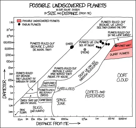

38
This graph from XKCD says a lot about why that is the case
The bottom line is, the 9th planet is too small to be detected through WISE, and too far/small to have been detected through visible observation. Most likely this hypothetical planet is a long ways away, possibly as far as 1200 AU, and not particularly large, making it difficult to see. WISE was able to rule out the existence of any Saturn sized object up to 10,000 AU. This hypothetical object is about 1/5th to 1/10th the mass of Saturn. It is also far more likely to be more compact, as Saturn is rather low density. Bottom line, if it is visible in WISE, it would be on the very edge.
Gallifreyan
  • 223
PearsonArtPhoto
  • 3,010
  • 28
    Who is 'me' here? Earth is probably not that far from me! – MycrofD Jan 23 '16 at 04:08
    Me is Randal, and he is measuring from the center of the planet. – hildred Jan 23 '16 at 04:49
  • Shouldn’t the region “planets we would see during the day” include the moon? – Peter LeFanu Lumsdaine Jan 23 '16 at 22:43
  • Yea, the chart isn't perfect. Mars shows up as further than Jupiter, for instance. That should be the case, and I don't think all of the planets are quite in the right area... – PearsonArtPhoto Jan 23 '16 at 23:07
    @Peter: I think the point is that the "visible at night" / "visible in daytime" line seems to be drawn at around 0.1 solar diameters, i.e. the size of a small red dwarf star. Basically, anything bigger than that would have to be a proper star, capable of fusing hydrogen and emitting its own light, which would make it more visible. But yes, to properly match the description, the line really should turn down on the left enough to include the moon (and, for that matter, the earth, and some birds and airplanes) in the range of daytime-visible objects. – Ilmari Karonen Jan 24 '16 at 03:09
    @MycrofD Randall Munroe is measuring distance between his location on the surface of the Earth and the center of any depicted object. I'm a little surprised he didn't include the sun on this chart. – WBT Jan 25 '16 at 03:44
  • The problem is 'me' and earth both should be at origin..that is what i think.. where am i wrong? – MycrofD Jan 25 '16 at 12:35
  • @MycrofD: As above, Randall is measuring from the center of planets. – Charles Jan 25 '16 at 14:14
  • So would the sun's center or edge be at the top of the main diagonal line that Earth is on (1 AU)? While I find the graphic cool and applaud the creativity, it's a bit unintuitive and hard to follow for me. I guess people's minds work differently than others and am glad it clears things up for others. – iMerchant Feb 26 '17 at 05:46
