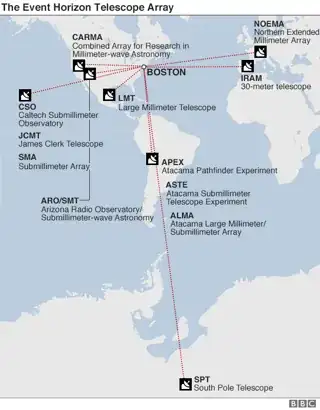

The algorithms they used at the time to generate that image from that pretty sparsely populated array of telescopes, for which at any given moment a significant fraction can't see the target, assumed that the the target was static, that it didn't change. See
- How can the Event Horizon Telescope image Sgr A* when it's not visible from all sites at one time?
- How does the Event Horizon Telescope implement the interferometry?
above: (click for larger) "The eventual EHT array will have 12 widely spaced participating radio facilities". From The BBC's February 16, 2017 Event Horizon Telescope ready to image black hole.
It's the same way we assume, or at least hope that our targets don't move much during our photograph exposure times of a fraction of a second, but for the EHT's image of M87* that shutter time was four days.
