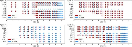

While the simple view is that the resolution is determined by the farthest baseline that the source is visible from simultaneously, the situation is more nuanced because with so few sites we really can't call this an aperture in a conventional sense. So you can still use a subset of all possible baselines to "fill-in" missing information and improve the image reconstruction.
You can see between 04h and 06h UTC the eastern-most site (PV; 30m dish in (Spain)) cuts out and the western-most sites (JCMT (Hawaii), SMA (Hawaii)) come on line.
A brief reading suggests that they stop using the data from a given site when the object drops below 20 degrees elevation above the horizon at that site.
In the second image below, you can see all sites used. The solid lines indicate baselines used to produce the image, the dashed lines indicate baselines used to collect data for calibration of the EHT network.
Figure 2. (of Paper III). EHT 2017 observing schedules for M87 and 3C 279 covering the four days of observations. Empty rectangles represent scans that were scheduled, but were not observed successfully due to weather, insufficient sensitivity, or technical issues. The filled rectangles represent scans corresponding to detections available in the final data set. Scan duration varies between 3 and 7 minutes, as reflected by the width of each rectangle.
