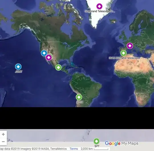

I went to https://eventhorizontelescope.org/array and read about the ten sites listed as part of the EHT, I have a mashed-up screen shot of them below.

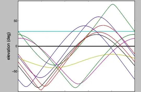

I made a little script also shown below with approximate coordinates, and saw that Sgr A* is at a declination of about -29.5 degrees (South). I spun it around the earth, calculated the dot product between each of the sites' position vectors and all normals pointing to Sgr A* as it rotates around the Earth.
I then plotted the elevation angle above the horizon for all ten sites. I was quite surprised!
  1. Sgr A* is never above the horizon for the Greenland telescope!
  2. Sgr A* is never simultaneously visible even to all of the remaining nine telescopes
Have I made a mistake? If not, how do these ten sites combine their data to image Sgr A*?

I don't think it is necessary for all the telescopes to view the target simultaneously if you can make the assumption that the source you are observing is only varying on timescales longer than it takes the source to be viewable by all the telescopes. Sure, the maximum baseline you can get will be defined by the most distant pair of simultaneously observing telescopes, but that doesn't stop you adding together images taken at other times.
This is very probably the reason why M87 is in the fact the first image presented by the EHT. The timescale for significant variability around this (big) black hole will be of order a few time $2GM/c^3$, which is a few days for the M87 black hole. Imaging Sgr A* is going to be more difficult (or at least more blurry) because the variability timescale is minutes.
It looks like (from the data reduction paper) that the first steps involve treating every baseline in a pair-wise way (as I suggested above) and then combining them across the network, with whatever baselines were observing at the time, to give data at the surprisingly (to me) high time-resolution of 10s.
Well, Sgr A* is not the only focus of EHT; the website mentions it also studies other objects like the M87 galaxy in Virgo which, at +12° declination, is visible from Greenland.
  1. Sgr A* is never simultaneously visible even to all of the remaining nine telescopes
Very Long Baseline Interferometry just combines the results of the telescopes which can (and have been) pointed at a specific target at a specific time (plus or minus a few nanoseconds, because some telescopes might be further away from the target than others, and light takes slightly longer or shorter to reach them). So it will never use the full potential of all the telescopes in the array simultaneously.
At the location of the correlator the data are played back. The timing of the playback is adjusted according to the atomic clock signals on the (tapes/disk drives/fibre optic signal), and the estimated times of arrival of the radio signal at each of the telescopes. A range of playback timings over a range of nanoseconds are usually tested until the correct timing is found.
