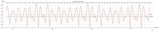

A few months ago, I added a link to an interactive 3D version of the Sun-SSB diagram to this answer. I used that Python code as the basis of a new script that creates 2D plots of the radial distance of the centre of the Sun from the SSB for any timespan in the Horizons database. It also integrates the mean radial distance over the selected timespan. Here's an example plot, covering 1700 AD to 2200 AD, with a timestep of 1 calendar year, which yields a mean distance of 829,224 km. A timestep of 1 calendar month gives a mean distance of 829,185 km. That's comfortably larger than 695,700 km.
Sun-Barycentre distance, 1700-2200
The vertical scale is in kilometres, which the plotting library prints in scientific notation, with "1e6" near the top of the axis. The horizontal axis is labelled with Julian day numbers, which are also displayed in scientific notation.

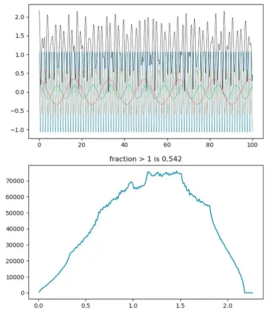

The Sun's motion relative to the Solar System barycenter is dominated by the four planets Jupiter, Saturn, Uranus and Neptune. Neptune is a lot lighter than Jupiter but it's also a lot farther away, and contrary to intuition the farther out it is the larger the induced motion in the Sun around the barycenter.
*To first order we can treat the Sun's response to each planet as circular, and the final result as the linear superposition of four circular motions.
I lack the math background to derive the answer analytically, though I am confident someone will soon.
Approximate distances of the Sun to the mathematical barycenter of each binary Sun + planet pair, "amplitude":

So the interesting thing is that if it were only for Jupiter, the Sun-Jupiter barycenter would always be slightly outside the Sun.
Let's run a simulation of four circular displacements with the amplitudes as shown and periods (not that it matters, as long as they are not rational number relationships) that scale as $a^{3/2}$ which conveniently will convert my four digit numbers into irrational numbers for me. :-)
As expected based on Jupiter alone putting the barycenter just outside the Sun, when all four main planets are taken into account the barycenter spends about 54% of the time outside the Sun (or the Sun spends 54% of the time further than one of it's radii from the barycenter).

The histogram of radial distances shows some interesting structure, which I think should be pursued further both mathematically and numerically.
Since this is a statistical analysis (there are no harmonic relationships between planets in this model) time could just as well be sampled randomly rather than using equal spaces.
Barycenter outside of one solar radius
In the plot above the $x$ value for each individual two-body motion is shown with color lines, but the absolute radial distance $r$ is shown in black for the combined motion.
