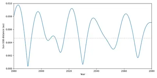

The solar system barycenter (SSB) is sometimes inside the Sun and sometimes outside. As an observer outside the solar system could detect with Doppler spectroscopy, the Sun is what's wobbling around.
The Sun's offset from the SSB is a vector sum of roughly:
  • 0.00496 au ±5% away from Jupiter
  • 0.00272 au ±6% away from Saturn
  • 0.00083 au ±5% away from Uranus
  • 0.00155 au ±1% away from Neptune
The other planets contribute much smaller amounts to the total. Each planet's contribution is proportional to the product of its mass and its orbital distance.
When these components add constructively as in 2020-2023, the center of the Sun can be as far as 2 R away from the SSB. When they cancel as in 2029-2030, the center of the Sun is within 0.5 R of the SSB. The solar radius R is 0.00465 au, shown here with a dashed line.
Plot of Sun-SSB distance vs. time

  • Nice graph! Did you create it using JPL Horizons data? You can clearly see the ~20 year period of the Jupiter-Saturn conjunction cycle. It'd also be interesting to see the corresponding graph of the SSB's (heliocentric) ecliptic latitude. Of course, the 20 year period would be less obvious in the direction graph, but I assume there'd be a ~60 year period (60 ~= 5 Jupiter periods ~= 2 Saturn periods). – PM 2Ring Jan 18 '21 at 19:17
    @PM2Ring Almost: I used Skyfield to read JPL DE430. – Mike G Jan 18 '21 at 19:22
  • @PM2Ring: What there is is rather a 179-year period, which I believe is due to what is called the great inequality of Jupiter and Saturn (which Laplace originally calculated to ~877 years, then to ~924 years, but now would be estimated to around ~895 years if I'm not mistaken (someone correct me if I'm wrong). Here I've used a JPL ephemeris to plot out the Sol-SSB distance in terms of Solar radii from year -2999 to 3000, demonstrating the cyclical nature of it: https://i.postimg.cc/k7sN5n4Z/Figure-1.png – Outis Nemo Jul 05 '23 at 09:56
    @Outis The ~179 year period relates to the synodic periods of (Saturn, Uranus, Neptune), relative to Jupiter, which are (19.863261, 13.812176, 12.782075) Julian years, respectively. Multiply those periods by (9, 13, 14) & we get (178.769349, 179.558288, 178.949050). We can find longer period solutions using the LLL algorithm. Here's a demo in Sage. Try larger numbers for the scale. You can put numeric expressions in the data list, and comment out data lines with leading #. – PM 2Ring Jul 05 '23 at 19:15
  • https://sagecell.sagemath.org/?z=eJxlUsFq4zAUvBv8Dw_3UCl1he12k3RBsPRQKKS33tKsEbaSitqSkWS55Ov75JhuYXUa6c3M0-jpCna7HVjZjo1XRqfJGThkWfaWJuUD267vqnWJ8I5ty6rcrBFWbLOtis2vNEFamqTJH6W9tKLxadLKI9Sk5-TaNaKT1zmURUFzaIUX_FkPo380nwRZYuw8P-fwLtXp3fN75IjRm3ockCr5k-icpL_TBHBFMV5qb83EnLdqIBSOxgLuQem5zNzQKd8pLR2hh4ssBBQF2Xhjyd6Jk6xlEB1B1X9yUMd5K3QL2viI98WB8-wqO9CL22AxJVmFkIOTA8_edJaD1O2MVhWNDzF37XOYYuMAK0DcSU1CWExesNALjPBJQo_10GMbiqFE80EuBXaW1pDptkQb-i274fDCXuFmUbNWiZPRmCb09G-F5-XC3Bd5cYj02RpLKyAT3ML99wUdRC8cen2yoieUvf4M6HKIgZbGP57JLcP4R43jGISyk3KyHqyJPyhGpV992qaX&lang=sage – PM 2Ring Jul 05 '23 at 19:16
  • @PM2Ring: Ah, I see; that's very interesting, thanks. Perhaps I'm misunderstanding what the great inequality is and how it ties into this, then. – Outis Nemo Jul 06 '23 at 18:31
  • @Outis Laplace's Great Inequality relates to the gravitational interaction between Jupiter & Saturn (and the other planets, especially Uranus & Neptune), so it includes effects due to mass, eccentricity, and inclination. In contrast, my LLL calculation is rather crude, since it's only based on the mean motions. FWIW, there's some info on the great inequality here: https://astronomy.stackexchange.com/q/48972/16685 – PM 2Ring Jul 06 '23 at 20:14
