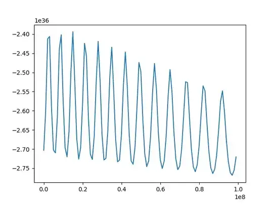

Let's consider a three body system of the Sun, Saturn, and Jupiter. In this system the influence of Saturn and Jupiter should clearly be visible in the resulting sinusoid. After integrating this system for $2$ Saturn years ($60$ Earth years) the energy-analogy over time looks like this:
It should be pretty clear that the above behavior can be created by two sinusoids with different frequencies, to any who find this unclear I recommend having a look at this tool. If wanted to we could use Fourier analysis to deconvolve those two frequencies and recover the orbital periods of Jupiter and Saturn (I will also neglect this for brevity).

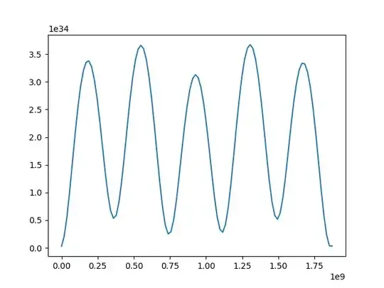

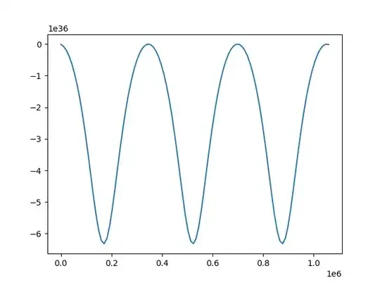

Let's consider a slightly worse case: a three body system comprised of the Sun, Jupiter, and a hypothetical hot jupiter with a semi-major axis of $1.55^{}$x$10^{10}$ m on a relatively circular orbit. Our energy-analog after $3$ hot-jupiter years ($12$ Earth days) looks like this:
Where did the other sinusoid go?
Its effect is still there, but we haven't sampled sufficient time to see it. We would need to look at $1,095$ hot-jupiter years ($12$ Earth years) in order to see one orbit of our toy Jupiter2 Fortunately we don't have to integrate quite that long to see the effect of the toy Jupiter on the energy-analog. After $320$ hot-jupiter years ($3.5$ Earth years):

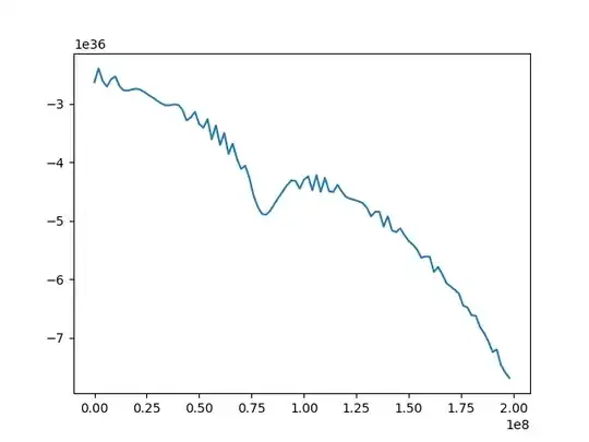

This becomes even more complicated with non-zero eccentricities and unstable orbits. For a similar three body, hot-jupiter system but with the toy Jupiter having an eccentricity of $0.65$ over a period of $7$ Earth years the energy-analog is:3
