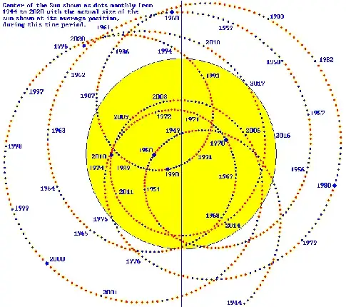

The Sun's movement in the Solar System can be thought of as its movement around all the individual pairwise barycenters at once, or as a movement around the Solar System barycenter, which itself is constantly moving.
Suppose Mercury was the only planet. The mutual barycenter of Mercury and the Sun is about 10km from the center of the Sun, which is inside the Sun. The Sun would be orbiting this barycenter inside itself every 88 days.
Now, suppose Mercury and Jupiter were the only planets. The Sun/Jupiter barycenter is located barely outside the Sun (about 1.07 Solar radii or 745,000km). In this two planet system, the Sun would rotate around the Sun/Jupiter barycenter about every 4,333 days, but at the same time, it would be rotating around the Sun/Mercury barycenter every 88 days. The center of mass of the Sun wouldn't quite be tracing out curlicues like a spirograph, but it would be wavering around its orbit of the Sun/Jupiter barycenter due to gravitational perturbations by Mercury.
If we consider the full Solar System, with all the massive bodies, the Sun is orbiting all the individual barycenters as well as the whole barycenter. Here is a picture of the movement of the Sun around the barycenter taken from ProfRob's answer to What does the Sun's orbit within the Solar System look like?. If we were able to "zoom in" enough, we would see the line "wiggle" due to the location of the inner planets.
Of course, this image is just created with the known Solar System masses. What happens if we eventually discover the theorized Planet 9? It could be out at 800 AU away with up to 10 times Earth's mass, giving a barycenter distance from the Sun of as much as 3,592,000 km (over 5 times the Sun's radius. If Planet 9 exists, we will then learn that this whole diagram might really be stretched out and slowly rotating around a barycenter as much as five Solar radii away!!!
Summary: The Sun rotates around the Solar System barycenter, but the barycenter is constantly moving since the planets all have different orbital speeds. The Sun's rotation around the barycenter is a strange wavering curve due to its simultaneous gravitational interaction with the rest of the Solar System bodies.
