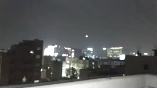

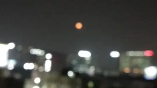

I wish I could attach a good quality photograph of this red color moon I'm looking at right now.
I searched on internet but there was no lunar eclipse scheduled to occur on 23rd December 2018
in HYDERABAD, INDIAN SUBCONTINENT around 7:20pm Please tell me why the moon is red tonight:) ?

First of all there could not be an eclipse on December 23rd because that is one day later than the full moon.
There can be a couple of reasons for the moon looking red or orange:
  1. It is near the horizon, and being viewed through the atmosphere over a large city. Air pollution (for example from cars, trucks, fires etc) push small sooty particles in to the air. These particles scatter blue light more than red, so there is less blue light coming towards you directly from the moon.
  2. Sometimes sand from deserts can get blown up into the atmosphere, and it can get carried a long way. The sand has a similar effect to the soot.

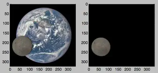

above: "Moon photobombs Earth" photo from DSCOVR, widely circulated NASA public domain image, from Why does the Moon appear gray when passing between the Sun and the Earth?
As a non-scientific enquiry, I took the photobomb image as-is and used my computer to color analyze the moon. I got this, which does show a definite progression, blue darker than green darker than red:
If I isolate the moon with Python and calculate the average pixel values in the R, G, and B channels, I get [0.33, 0.31, 0,28] which is a pretty good match to the albedo plot if I just look at the plot around 450, 550, and 650nm, (which is what normal people do after spending hours trying and failing to understand the intricacies of human color perception).

@uhoh makes good points. Moonrise was 6:34pm on December 23th in Hyderabad. Azimuth 70.5 degrees (i.e. approx ENE), and altitude approx 9.2 degrees above the horizon. Therefore the moon was likely too far due north from the Krakatoa volcanic plume to be a reddening factor. The reddish moon in the picture that OP posted is likely due to the effect of the thick atmospheric layer that the moon's light had to travel through at that low angle, over the city of Hyderabad. I don't know much about the condition of air pollution/dust in that area, but @Wayfaring Stranger noted that air pollution was high on Monday 24th Dec.

    Thanks for your answer. It's interesting but there are some big technical problems. 1) the biggest effect should be the local atmosphere between viewer and the Moon, and Florida's sky is unrelated to Hyderabad's. 2) Light from Sun illuminating Moon only passes through Earth's atmosphere around the time of a lunar eclipse. Here the light passes through space, thousands or probably tens of thousands of kilometers away from the Earth. 3) Your images are from different telescopes and so different cameras, no reason to expect them to be comparable, no evidence they've been calibrated correctly. – uhoh Dec 25 '18 at 23:45
Particulate air pollution was quite high in Hyderabad on Monday. 181 particulate Monday vs the usual 98. The link doesn't seem to say what the units are, but it does say it's all particulate, and that it is "excessive pollution". Note that the contents of this link probably change on a daily or hourly basis. Is this the time of year when the rice farmers burn the stubble in their fields? If so, it's probably smoke making the moon so red.
