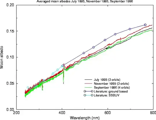

Reflected moonlight is actually slightly reddened compared with the incident solar spectrum (Ciocca & Wang 2013). That same light is then transmitted through out atmosphere in exactly the same way as sunlight.
Any phenomenology (which appears disputed) as per the claim in the question is purely down to the nuances of our colour perception.
Figure 8: Averaged geometrical moon albedos measured by GOME from July 1995, November 1995, and September 1996.
From ESA's GOME moon measurements, including instrument characterisation and moon albedo.
6If I read the legend correctly, the two spectra are taken at different angles and thus different amounts of atmosphere to pass through. Seeing as the question includes that as a possible mechanism, perhaps some further explanation in in order? – AaronD Jun 27 '18 at 19:14
6@AaronD Indeed, the Moon was observed at higher altitude so is less reddened by the atmosphere than for the solar spectrum. Thus the intrinsic difference is (a bit) greater. – ProfRob Jun 27 '18 at 19:42
1I hope you don't mind, I stumbled across your answer and noticed that the link is paywalled, so I added a 2nd source from answer to Why is this moon red? – uhoh Jan 25 '19 at 08:05

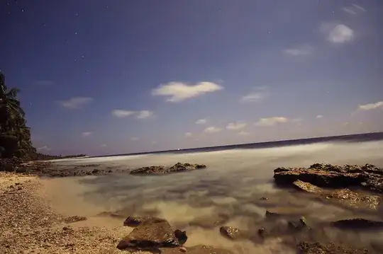

Yet, on clear nights, with the full moon high in the sky (as little atmospheric influence as possible) the landscape around us appears blueish, because of the Purkinje effect: at low illumination levels our red color sensitivity decreases (as our vision system gradually switches from daylight (cones) to night time vision (using rod cells)).
Yes, the moon surface is bright enough and its color can be seen correctly (not distorted by the Purkinje effect). So how how does it relate to the question, where we ask about the moonlight color? In my opinion, we tend to perceive the general impression of the color by looking at the surroundings, not just the light source.
That's why the sunlight looks "warm" (more yellow) and the moonlight looks "cold" (more blue - because our color perception is changed by the insufficient light level), even though the real colors are pretty much the same.
In fact, this is can even become a real problem when taking very long exposure photos at night! They look almost like daylight photos, destroying the intended atmosphere of mystery.
Objectively, the photograph is correct, but it is not what we see with our own eyes. Add some blue tint and the night feeling is back.
Example: (note the stars, this is certainly not a daylight photo!)
Abrahim Asad - Mathimago fanni Athiri, Fuvahmulah Beach on Full Moon Night LongExposure (CC BY-ND 2.0)

The full moon is too bright I think for the Purkinje effect to be significant. – ProfRob Jun 27 '18 at 21:24
3@RobJeffries exactly, that's why I think the "cold moonlight" impression (distorting our moon color judgement) is caused by the "blue" moonlit surroundings, even though the moon surface itself is bright enough to show its true white color. – szulat Jun 27 '18 at 21:45
2@RobJeffries From the linked Wikipedia page, "This is why humans become virtually color-blind under low levels of illumination, for instance moonlight.". Note that it's the color of things lit by moonlight, not the surface of the lit moon itself. – JollyJoker Jun 29 '18 at 08:43
2@JollyJoker Indeed that is what I had misunderstood about this answer. However, the question is clearly about the appearance of the moon, not about the appearance of objects illuminated by the moon. The full moon is bright enough that scotopic vision is not an issue. – ProfRob Jun 29 '18 at 10:19
1It's still a valuable contribution to this discussion, especially given the abundant conversation about how the sun's color is discerned in its reflection by earthly objects. Thanks for posting this. – lly Jul 01 '18 at 12:32

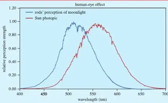

I agree with Jack's comment, it's partly misconception and party due to the way rods and cones work.
In "By the light of the silvery Moon: fact and fiction" (from where the illustration and quotes were obtained), by Marco Ciocca and Jing Wang, they explain:
Page 365: "The rods are effectively colour blind. Scotopic vision has a higher sensitivity to light levels than photopic, but is effectively colour blind. We convoluted the sunlight spectrum shown in figure 5 with the photopic response above and the result is shown in figure 8.
Figure 8: Perception of sunlight and moonlight due to our eyes.
During the daytime photopic vision clearly dominates, and the resulting spectral distribution of perceived light, even without considering the lack of blue components of the solar spectrum due to atmospheric scattering, is clearly shifted towards yellow-green (560 nm) because cone sensitivity is biased towards that part of the visible spectrum $^{[20]}. There is little sensitivity below 450 nm, with the peak at 560 nm returning to zero at 700 nm. Therefore sunlight appears strongest around 560 nm (yellow-green, the colour of tennis balls, unsurprisingly), and that is why we think of sunlight as golden.
On the other hand, rods show a much more sensitive response towards shorter wavelengths (rod vision shows a peak around 510 nm), but are unable to detect colour. To show the peak response of the rods we convoluted the Moonspectrum of figure 5 with the rods’ response. The result is also shown in figure 8. If the light was so low that only the rods were detecting it, the Moon would appear white because the rods are colour blind and our convolution would not lead to a colour bias. In reality, however, at the light level of moonlit landscapes human eyes are working in a condition that has been dubbed as mesopic vision, a combination between photopic and scotopic vision in dim lighting $^{[16, 17]}$. Cones are still furnishing information but at a reduced rate, while the rods, with their superior light-level detections, allow low light-level sensitivity. Under these conditions, the rods couple to blue receptors in the cones to show blue light $^{[3]}$. There seems to be be, therefore, physiological reasons why moonlight appears bluish."
Page 366: "Our perception, then, of moonlight as a colder, silvery light with a blue tinge is acombination of two effects: a physical one due to diminishing Rayleigh scattering as the Moon gets higher in the sky and a physiological one (knownas the Purkinje shift $^{[6]}$). The physiological shift is because cones are more sensitive to yellow-green light, whereas the rods respond best to green-blue light $^{[20]}$ and couple back to blue cones $^{[3]}$. This bias of our eyes towards shorter wavelengths in dim light creates the illusion of a colder bluer moonlight, even though moonlight is actually overall redder than sunlight."
Note: Figure 5 on it's own is misleading due to the above explanation and this text in the paper which explains figure 5:
Page 363: "We also compared the Moon at altitude 57° spectrum with sunlight in figure 5, which is normalized the same way as in figure 4. Since direct sunlight will damage the spectrometer, the data were collected with the telescope–spectrometer pointed in a direction at as small an angular distance away from the Sun as prudent. We did so to protect the instrument while at the same time trying to minimize atmospheric effects.
The data presented in figure 5 needs to be compensated and convolved with the spectrum of eyesight under bright and dark conditions, as shown in figure 8.
