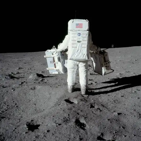

EDIT: I just ran across these images of astronauts on the surface while reading this answer. Their suits are not 100% white to begin with, but the Lunar soil - at least in these locations - is significantly darker. It is close to the same color as the (presumably) nearly-black radiator fins for the heat sink of the RTG unit (2nd photo) at the astronaut's foot.
above: "Buzz Aldrin carries the EASEP." from here
above: "Astronaut Alan L. Bean from Apollo 12, put the Plutonium 238Pu Fuel from the Lunar Module into the SNAP 27 RTG" from here.
above: Image from NASA/NOAA from Bad Astronomy

    @Will I'm not an expert, but yes; if there was something Earth-like (or even a giant, diffuse white pingpong ball) somewhere near the Moon it would have a surface brightness way brighter than the Moon's! If you had to choose a crayon to draw the moon on white paper you'd have to choose a dark gray, and then add just a slight amount of brown or red to it. The photo of the astronaut with the dark gray soil on their suit is the reality. I was quite surprised when I researched and wrote this answer as well. – uhoh Jan 20 '22 at 21:32
