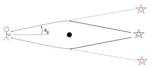

Gravitational lensing
This is by far the most well known. It has been mentioned by the others, but I'll touch on it.
Light coming from distant bodies can be bent by gravity, creating a lens-like effect. This can lead to multiple or distorted images of the object (Multiple images give rise to Einstein rings and crosses).
So, if we observe a lensing effect in a region where there isn't any visible massive body, there's probably a black hole there. The alternative is that we are peering through the dark matter 'halo' which surrounds (and extends passed) the luminous components of every galaxy and galaxy cluster (See: Bullet Cluster). On small enough scales (i.e. - the central regions of galaxies), this is not really an issue.

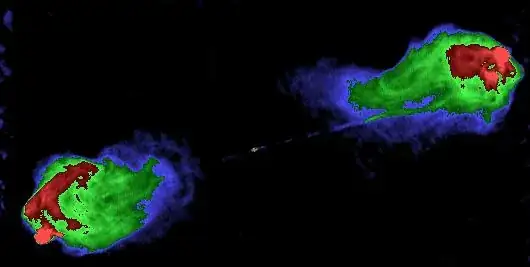

Cosmic gyroscopes
Cyg A is an example of this. Spinning black holes act like cosmic gyroscopes — they do not easily change their orientation.
In the following radio image of Cyg A, we see these faint gas jets emanating from the central spot:
These jets are hundreds of thousands of light years long — yet they are very straight. Discontinuous, but straight. Whatever object lies at the center, it must be able to maintain its orientation for very long.
That object is a spinning black hole.

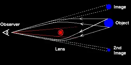

A black hole can also be detected by how it bends light as various bodies move behind it. This phenomenon is called gravitational lensing, and is the most visually stunning prediction of Einstein's theory of General Relativity.
This image portrays the geometry of gravitational lensing. Light from luminous background objects are bent due to the warping of space-time in the presence of mass (here, the red dot could conceivably be the black hole in question):

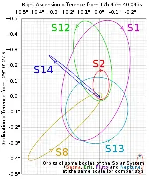

Astronomers have discovered the existence of a super-massive black hole at the center of our very own Milky Way Galaxy, and has been dubbed Sagittarius A*.
Over a period of ten years, the trajectories of a small group of stars have been tracked, and the only explanation for their rapid movement is the existence of a highly compact object with the mass of about 4 million suns. Given the mass and distance scales involved, the conclusion is that it must be a black hole.
Trajectories of stars around the Sagittarius A* within the Milky Way Galaxy.

  • As your picture suggests, their elliptical trajectory also strongly suggests the central object is not only very massive but also extremely compact. – chris Mar 29 '14 at 18:22
    *No * black holes have been found using the first method outlined in this answer. – ProfRob Oct 16 '15 at 16:07
