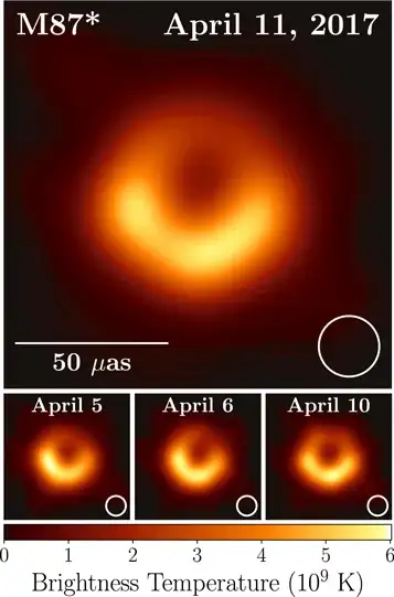

All this has changed with the release of a reconstructed millimetre-wave image of the supermassive black hole at the centre of M87.
The image below, obtained by the "Event Horizon Telescope" (a global interferometer) is formed by intense light from accreting matter being lensed by a 6.5 billion solar mass black hole. The dark circle is known as the "photon shadow" and is about two times the size of the black hole event horizon. The bright ring is caused by the lensing of light from around and behind the black hole. It is thought to be asymmetric and off-centre because of the black hole rotation.

EDIT/UPDATE: This morning (April 10, 2019), the Event Horizons Telescope held press releases on four continents announcing that they have indeed imaged M87*, a black hole of an estimated 6.5 billion solar masses in the Messier 87 galaxy, some 55 million light years away. Strictly speaking, we still cannot see the black hole itself but rather its epiphenomena such as the accretion disk and the turbulence caused by the presence of the black hole. This image, created by very long baseline radio interferometry, is not a photograph in the traditional sense, but rather a false-color image composite generated by converting enormous volumes of radio wave observations with a supercomputer into an image visible to the human eye.
