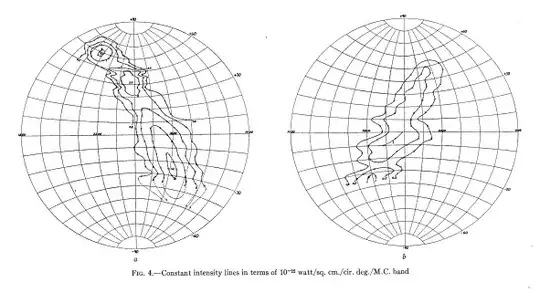

Let's take a look at Reber's initial paper1 where he first mapped the sky:
In the diagram on the left, from top down, the three peaks in the contour map are Cas A, Cyg A, and finally Sgr A. The latter two have black hole origins, the former is a supernova remnant.
The resolving power of Reber's telescope here seems to have been 6 degrees, and it was 31.4 feet in diameter (and he focused on a 1.9m wavelength).
Now, by the Rayleigh criterion, the angular resolution is proportional to the wavelength divided by the diameter. As mentioned before, this is the major limiting factor for radioastronomers, and will be what holds amateur radioastronomers from making great telescopes — amateurs usually don't have acres or land in which to build a good interferometer (let alone the precision), and single-dish telescopes can't be made too large by an amateur. One may notice that I'm citing rather old observations here, on old telescopes; however given that radioastronomy technology has not changed nearly as much as size has, it should be OK to compare amateur telescopes with the smaller telescopes of the past.

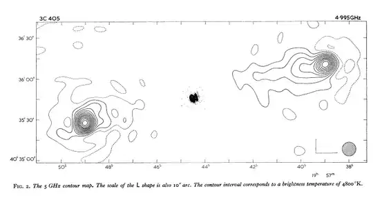

Let's have a look at Cyg A with a better resolution:
(From this paper2, using the 5km array)
Note that the black blob in the center is the actual galaxy (probably an optical photograph superimposed on the contour map).
We can see that the lobes are less than a minute wide. (The actual galaxy is around 50 arcseconds wide)
To me, the most interesting thing that one would like to see here are the gas jets coming from the central galaxy. As mentioned in my answer here, these radio-emitting gas jets are in a steady line over thousands of light years, indicating that they come from some sort of cosmic gyroscope which has been steady for very long. However, even with the Ryle telescope the 1969 people could not get a picture of them; just a slight hint of their existence from the shape of the lobes.
Alright, so no gas jets. What else can indicate a black hole? They could try to look at the lobes themselves. They do not directly indicate the existence of a black hole, but their shape hints towards them being formed from jets (this is pretty much in retrospect).
However, with lobe dimensions of less than an arc minute, there's not much an amateur can get here, either. It's possible that a really good amateur telescope would just manage to notice that there are two lobes, but not much else as far as I can tell.

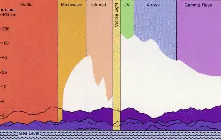

another problem for an amateur looking for black holes is that the telltale signature of a black hole, coming in the form of continuous or bursts of X-rays and gamma rays, cannot be observed from the surface of the Earth, because the atmosphere (thankfully) protects us from that sort of stuff.
Transparency of Earth atmosphere to EM spectrum
So that is why you need to go in space, or on the surface of a planet without atmosphere (the Moon would be suitable, Mars should do as well, since the atmospheric pressure is 6 millibars there and space rays come all the way to the surface, compared to 700-1000 millibars on Earth at sealevel), or send up your own space telescope, such as the likes of
