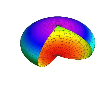

Current understanding is that star is an oblate spheroid. An extreme example is shown below.
oblate spheroid
For a neutron star, the difference between the polar diameter and the equatorial diameter is around 10% and would look more like this:
neutron
